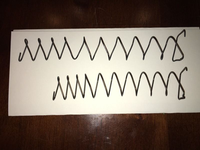

I hate to leave a thread hanging but I also like to give it time to test a product and make sure it works as advertised. I bought 10 new springs for the mags and they have been running great. I used springer precision dimpled springs and after leaving them loaded for several months they haven’t lost any length to the spring from compression.
Here is an example of the old Springfield springs to the springer precision springs.
Notice how short the original spring compared to the new one. After seeing this I started wondering if the original spring was for the 16 rds mag and was installed in the 19 rds mag.
Anyways I’m happy with the springs. I might have to upgrade other springs in the gun because some are feeling weak. One example is ejection/extraction and firing pin spring.
ETA: the springer springs were tough to fully load the mags to 19 rounds but after a few range trips they are a little more manageable. The first few times you might need a mag loader. But I’m impressed.
