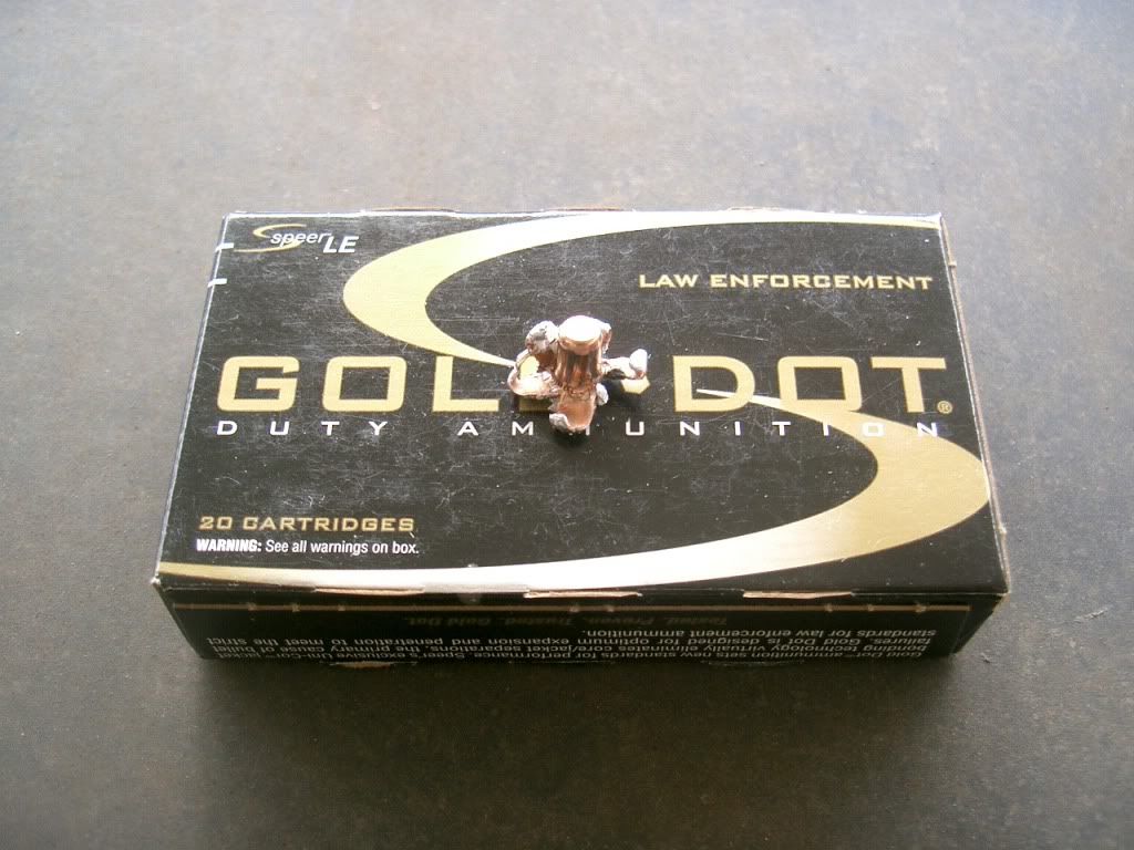

Here’s a pic of a 77 gr match and a 75 gr PRVI Hollow Point bullet. I like the 64 gr Gold dot, but going heavy match keeps me all the same on zeros and what not.
markm which bullet is which in the above pic? Am getting ready to pick up some of the Prvi 75gr for accuracy testing out of two of my rifles, if things work out will pick up more to stockpile for a rainy day, have a 1/9 that I’ll run a little through, but that is not a primary and is only really kept around because it was my first AR and is a good way to show people the differences of a good AR opposed to one that has had corners cut in the making.
The GD is bad ass too. But it’s easier to go all 75-77 grain across the board. Perhaps you could map 62 gr SS109, but then you’re stuck shooting those crappy bullets for practice. I don’t know… this is just my insance rationalization. :wink:
On the right is the 75 gr PRVI match bullet that you can sometimes get at Wideners. It’s decent in the accuracy departement. 1.5 MOA most of the time for us, but others have got it to shoot better than that. I replaced my XM193 stash with some of these loaded fairly hot.
