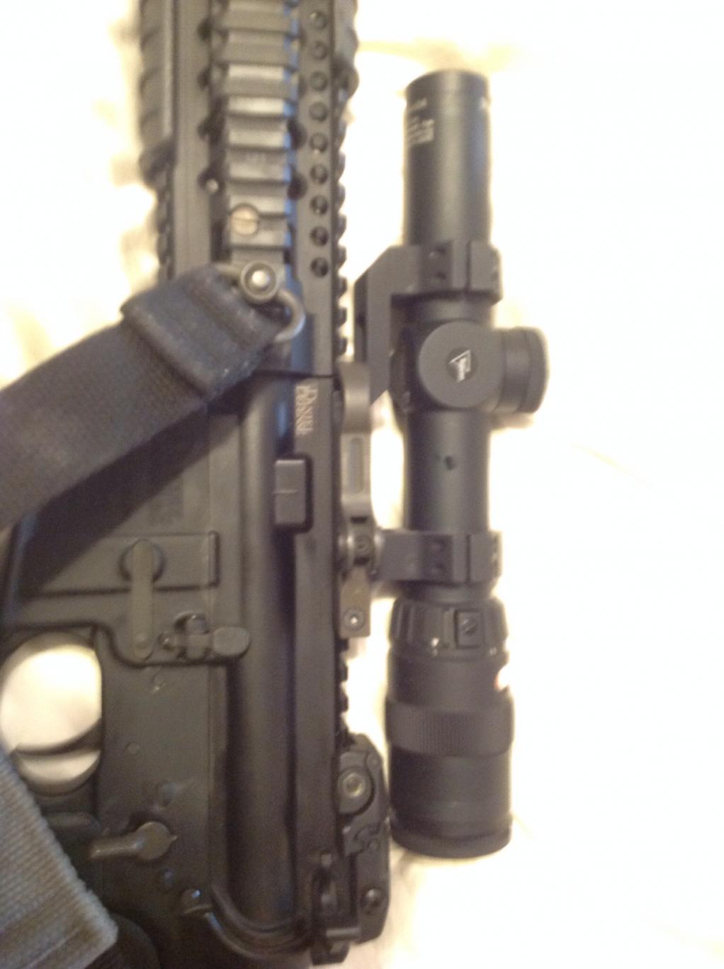

I set my 1-4 up as my primary with a QD mount understanding I could not deploy my rear back up sight with my scope attached. In 30 years I’ve had exactly one scope go completely TU on me and that was a Monkey Ward one back in the '70’s. By TU I mean fogged over couldn’t see through.
If my Trijicon goes dark on me I’ll detach and deploy the BUIS. And use the the dead scope as a hammer. Here’s my setup:
