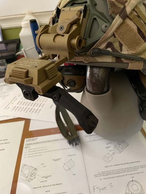

I’m just getting into NV, I went eith the Wilcox G24 and a Noisefighter AX-14. The AX-14 has a joint in the middle that alows it to have an extra pivot point which should be a step up from the original J-arm.
If you didn’t want that feature you could probably just tightened that joint up (uses and allen key bolt with nut on the back thats retained into the arm). This would likely give you the return back to original position you were looking for.

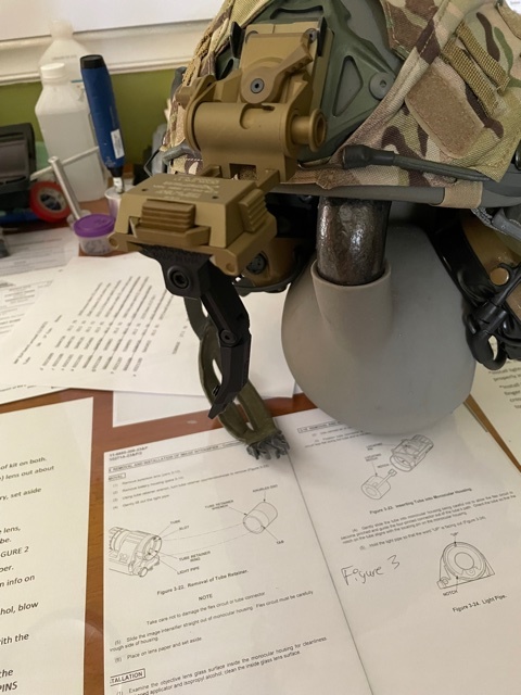

This is what I have (thank you @Lowdown3), I just got it but I like it so far. I like how the AX14 has the pivot point in the middle. Let’s you get closer to your Helmet when stowed up, or you can swing up as if it were half a set of binos.
