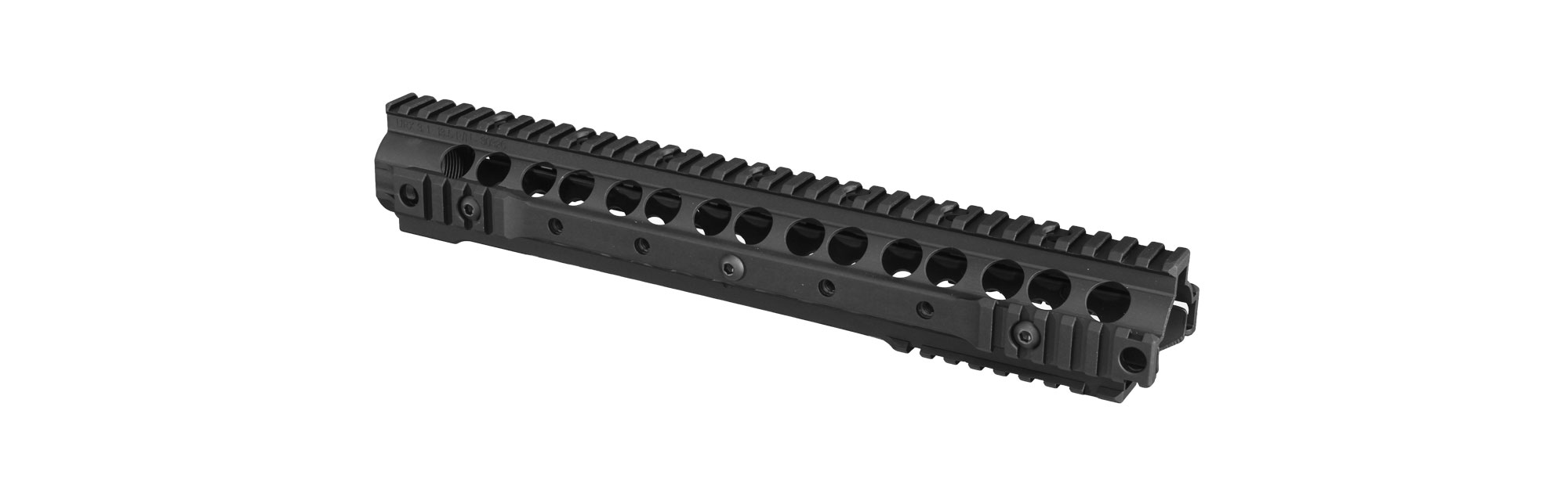

-KAC M4 Ras Blem/ I’d like to add a QD mount and a light in the future

  • Handguard; The RAS is great for an inexpensive, proven, drop-in rail. Since you mention wanting to add a QD mount and a light, I would look at something that has the QD from the start… Daniel Defense’s offerings, Centurion Arms C4, LaRue… You could also look at going with something like a KMR7 or MI Gen 2 SS and forgo the quad rail altogether, or an FSP rail to extend past the FSB if you think that would be at all beneficial to you. Lots of good handguard options out there that might suit your needs better. Just some things to look at.

For the kac ras. Iv got a lot of time behind one, and if you needed a laser (peq15) than it might not be a bad choice. But if you just want to mount a light and maybe vfg I think the magpul hand guards (~$40) are a better bang for the buck. But if you want a real modern tube the alg tubes ($110) are amazing for the price.

There are some good handguards available that frankly beat the RAS. The biggest question is what are you willing to spend, what do you want them to do that the MOE doesn’t, and whether or not you are willing/able to either install a more solid rail or have someone do it for you. Getting rid of the front sight tower opens you up for a better selection of rail options. One of my favorite handguards is the KAC URX3.1, but it requires someone with the right tools and knowledge for installation.
Yes, I do work for KAC, and yes, the Mod 1 and ECC were primary drivers in making the decision to come here.
If you don’t want to do much work, and/or don’t want to cut down or replace the standard A-frame, of what I have used, I do like the Centurion Arms options.
The most direct drop-on, with an increase in capability, is the C4 Rail, Carbine Length Cutout Rail Handguard. It puts rails out beside the front sight base, so you can at least push a rail-mounted light out of the critical grip area on the HG. The only work you have to do is cut off the delta-ring and spring, and pull off the handguard end-cap just behind the FSB. It is, of course, much easier if you have the tools and ability to pull the FSB and barrel nut, but not absolutely required. You can see them over at centurionarms.com.
