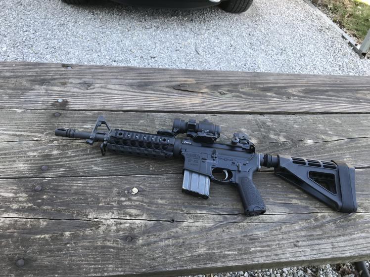

I have the Geissele Super 42 in my 11.5" BCM AR pistol. Not a lot of rounds through it (under 500) but it works fine with no problems. I had a few ejection problems early on but that was gone around 50 rounds or so.
