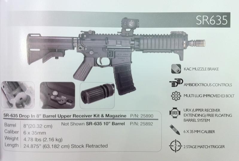

I actually believe the OP is asking a legitimate question and a number of other people are looking for similar uppers.
What the OP is looking for is a 9mm flattop forging but milled for 5.56 parts
KAC had made some prototype SBRs with this forging.
I have also tried to get some companies to start making these uppers but this idea seems to elude people.
I will try to get a picture up tonight of what I am taking about.
Attached is a picture of what the OP is looking for.
The closest thing to that is the billet offering from Rainier Arms, Sun Devil, AllStar, or Edward Arms that I posted before:
http://shop.sundevilsales.com/223-Slickside-Upper-Receiver-Black-SD15URSS.htm
https://www.edwardarms.com/shop/billet-upper-receiver-ar1/
If the op doesn’t want billet and wants a standard forged receiver, he’s going to have to get a 9 MM upper receiver and send it off to ADCO or something to get modified for the gas tube and possibly a cam pin relief depending on where he gets it from.
The issue here is that he doesn’t want a brass deflector. His options open up tremendously if he decides to get one with a brass deflector. Otherwise, it’s going to require some minor machining.
Yes we understand this.
The problem with billet uppers is they are too thick and thus heavier than a forging.
Someone in the industry needs to start making the uppers en mass as I posted above.
They would appeal to varmint gun guys, lightweight builds, and PDW style builds.
