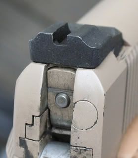

The Kimber Novak style cut usually has a flat spot on the top of the slide just forward of the rear sight dovetail. The true Novak doesn’t. This is my Springfield 1911 with a Warren plain black rear sight and a front night sight from Dawson. This gun is a constant work in progress. I plan to replace it’s frame with a Caspian Race Ready Recon frame.
I’ve loved that gun ever since you first posted pics of it.
Just checked mine, and yup, flat cut in front so I’ll have to wait until Scott makes one specifically for a Kimber. Would be cool if someone who knows him would drop that hint… :cool:
