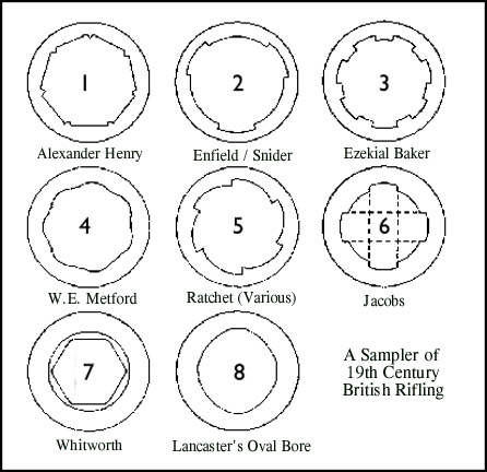

I’m surprised that is patentable. That’s just a minor rehash of ratchet rifling that has been around since the 1800s. I doubt it has any advantage over ratchet rifling where the root of one land starts at the terminus of the preceding. I don’t think it is bad, just not of advantage.
I personally like ratchet rifling. I think it exposes fewer land corners to potentially chip off in the throat, prematurely destroying accuracy.
