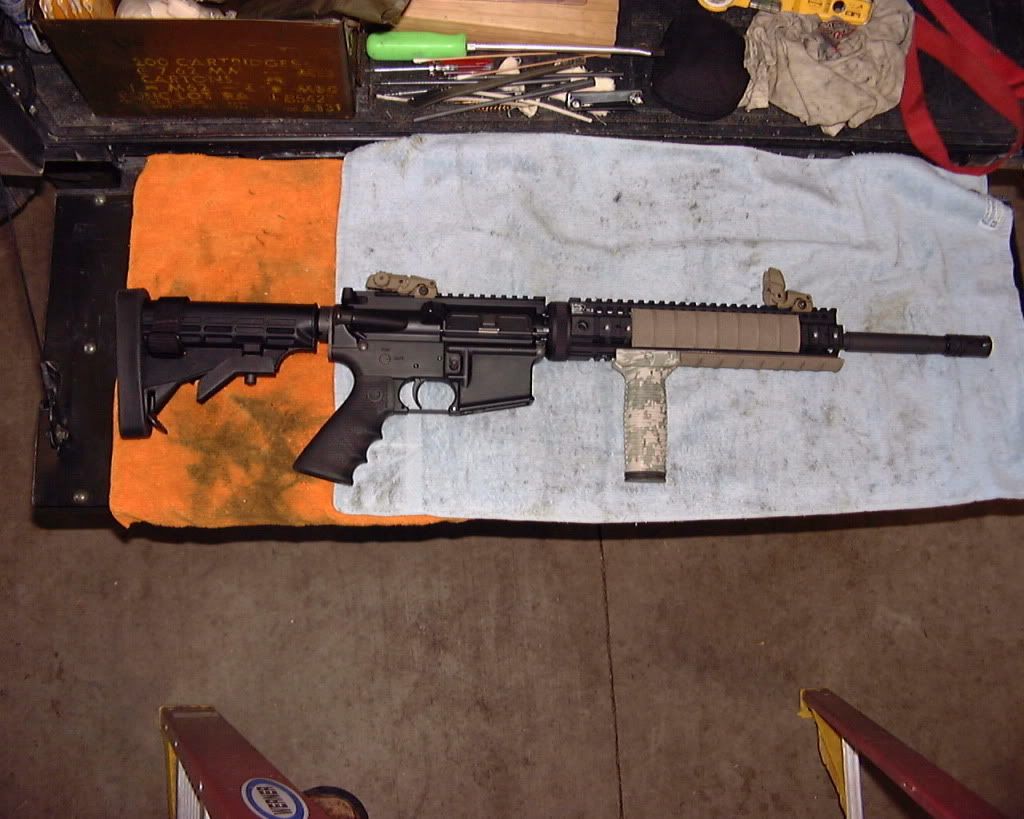

Went to the range today to sight in my M4 16 " carbine after putting magpul mbus sites on.
At 25 yards I was shooting about 18-20 inches high !
I adjusted the front sight post damn near all the way up and was still about 4-5 inches high at 25 yards.
Rear Mbus is mounted on a DPMS flatop, as far to the rear as i can get it.(about where carry handle sight sits)
Front Mbus is at the very end of a Larue 11" FF handguard (larue gas block).
So, What am i doing wrong?
I am about out of threads on the Front sight post.
Do the Mbus sit that much lower than a factory front sight?

I would take a pic and post it showing the upper receiver and rail, side view with a straight edge. There has to be some alignment issues to be that far off.

I stated in an earlier post that my setup had a Larue 11" FF handguard, with a Larue gas block. The Larue handguard slides over the Gas block. The front sight IS NOT mounted to a GB with a pic rail on top of it
The Mbus front sight is mounted in slot 35 on the HANDGUARD.
The Mbus rear sight is mounted in slot 3 on the UPPER RECIEVER.
I just checked square on the flat top reciever to the handguard.
It is perfect. I removed the handguard, and remounted it. Still square.
I ran my straight edge down the side of the upper rail, and the handguard, perfectly aligned.
I removed the flash hider , slid the stock front sight back on, up to the handguard.I leveled across both sight tips.
The mbus sight tip appears to be very close to where my original sight tip is.
The front sight tip on the mbus is barely protruding above the sight ears when i straight edge across.
I am not in anyway blaming Magpul for any of the Issues I am having. They make kickass gear, and it’s all top quality.
The Mbus set was from a reputable dealer on E-bay. They are new, genuine Magpul, complete in the boxes w/ instructions. Not airsoft junk
I simply wanted to know if anyone else had a problem where they had to raise the front sight tip that much,to where it is unprotected by the sight ears or if it is normal.
I was only able to get one picture. The others didn’t turn out do to the fact my daughter seems to have ruined my good digital camera. So, I was stuck trying to use, what I am sure is, the 1st digital camera ever made.

I’d like to see a good down angle shot from the rear of each sight, a shot of where the LaRue meets the upper and a head on shot down the barrel showing the space between the barrel and the LaRue.
