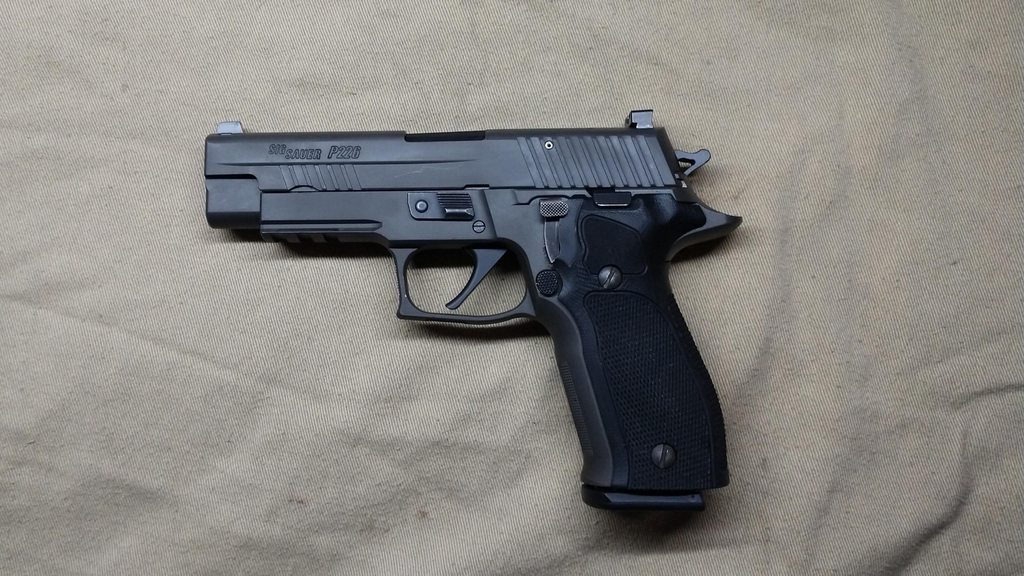

Their improved hammer strut makes for a much smoother DA pull, comes with three hammer springs, I run the 19# one in my 226.
6.5# DA and a 3.5# SA pull using their ELS trigger.
Not much Legion left to it anymore, just about everything swapped out.
Trijicon HDXR sights with an orange front dot, I have those on others too.
Houge P226 Allround grips cut to fit with Mecgar 18 round mag.
