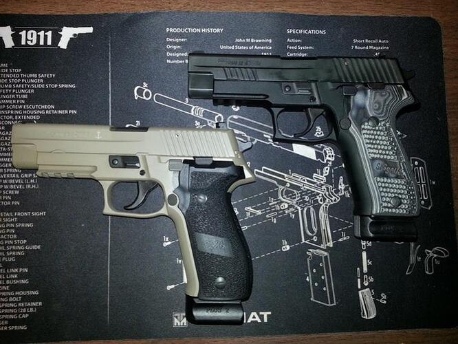

I’m looking to pick up another P226 and was considering these two models. Extreme has Hogue G10 grips and SRT trigger. Combat has tan frame (anodized I think) chrome-lined barrel, phosphate internals, and 1913 railed frame. I like the Combat but I’m wondering if I’d be better off with the SRT trigger. I’m also not sure if I want the 1913 railed frame, as it might limit holster selection. Combat will be about $100 cheaper as well. Also considering other models, mainly the MK25. Appreciate any input.

Correct me if I’m wrong, but isn’t the Combat essentially a Mk25 with the short reach trigger and tan frame?

They are virtually identical, I believe. The MK25 has the coated internals and I can’t remember if the Combat does or not. I have a 226 Combat with about 4500 rounds through and it’s a very nice handgun.

Actually it’s not a Combat, it a MK25 Desert. Regardless you can’t buy just one!

Thanks for the replies. Still trying to decide. I’m leaning toward the Combat, but I kinda wish it had the short reset trigger. It does appear to have the short reach trigger, but I’m not sure if that is a good thing since I have large-ish hands. Seems like all the SRT models come with the shorter trigger as well. It will probably fit me fine but I’m pretty used to the standard trigger. If the SRT is trouble-prone maybe I’d be better off to skip it anyway. I had never heard of any failures before.
