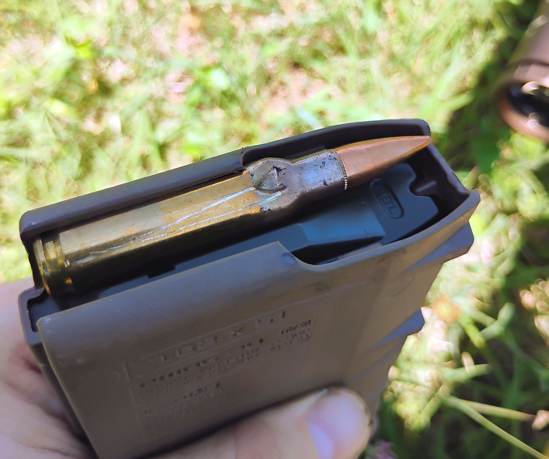

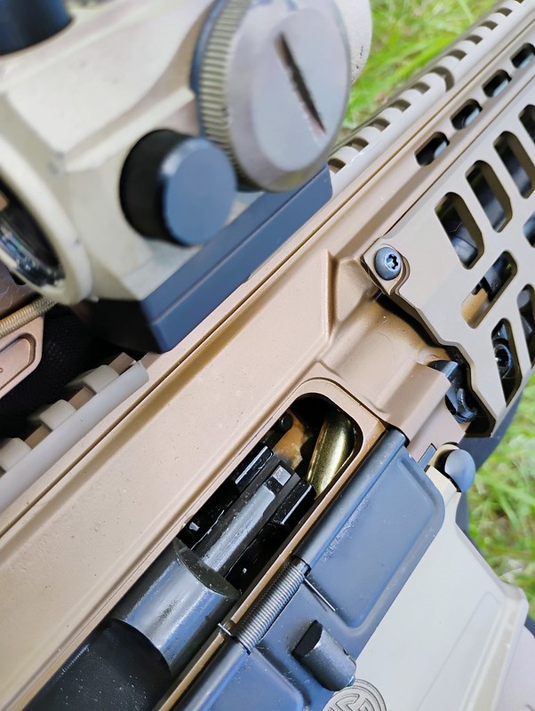

Only malfunctions I experienced through the course of the day were a few failure to feeds, always on the last round in the magazine. Some times it would try to feed the round, and the bolt would smash the case a bit, and other times it would just close on an empty chamber. (thinking about it now, it seemed to be worse earlier in the day than later, with the first couple rounds bent badly, but later ones still very much capable of being fired) I didn’t jot down which magazines this happened with, but it was with both MagPul LR/SR PMags, and Lancer L7AWM mags. Hopefully it’s just a break in issue, and it’ll work itself out over time, but we’ll see. Going to look into the issue and see what I can find.

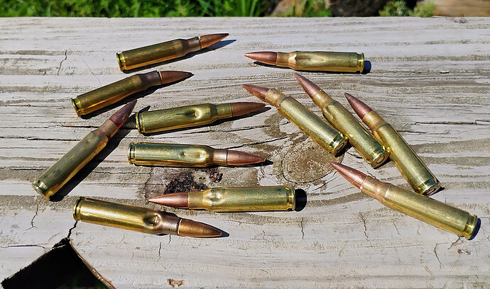

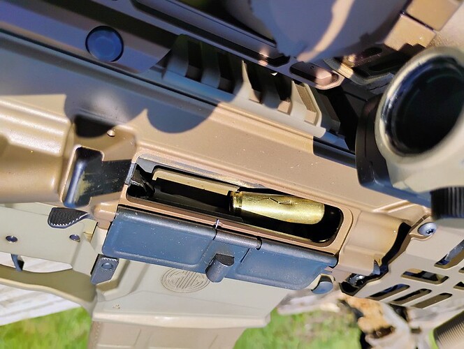

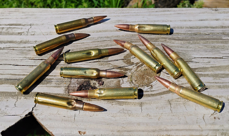

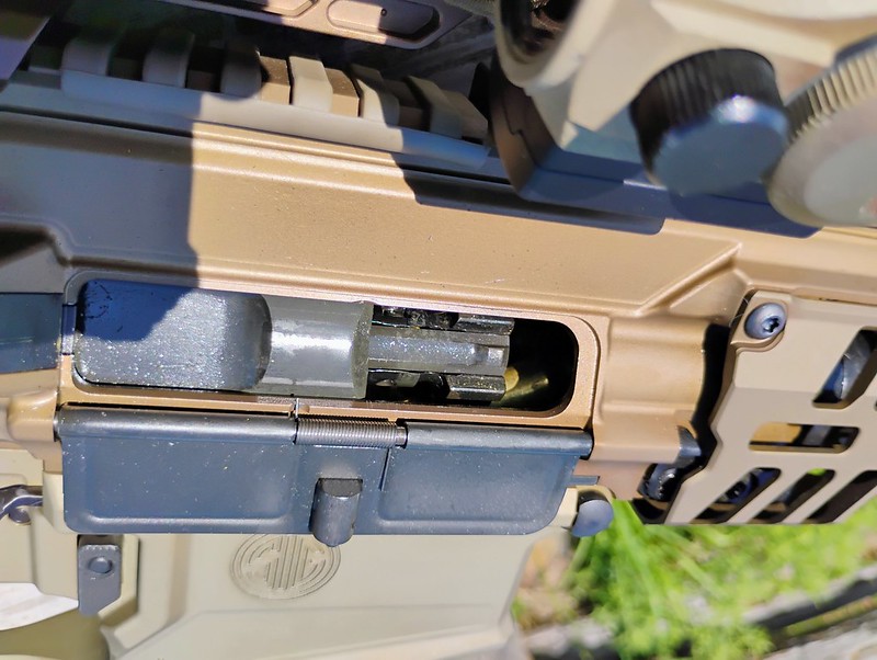

Out of about 350rds downrange today, upwards of 10% had feeding issues of one type or another. The last picture shows the ones that were damaged enough I didn’t apply “if it seats, it yeets” to. More were only slightly dinged, or just didn’t feed and were shot. First trip also had the same issues, but seemed to settle into just not feeding correctly by the end. Total rounds through the rifle is approximately 550-600. Mags are new, ammo is all factory from 4 manufacturers (Winchester/Lake City, PPU, PMC, and IMI), and the problem also occurred last time with Hornady Z-Max and Federal Gold Medal Match. The same problem occurs whether the rifle is being fired prone supported, seated, standing, etc. Kit/no kit also doesn’t matter. It’s not every mag, but ebbs and flows, sometimes back to back, and other times with a couple of functional mags worth between issues. Usually on the last or next to last round in the mag, but not always.
Based on most folks thoughts, its gas system needs work, and it’s going to have to go back to Sig. Well, damn.

Shortly after that post was originally made, I ended up sending the Spear back to Sig. According to tracking, they got it Monday, 15 July. I went into work yesterday, 23 July, and found a Spear sitting on my desk. Turns out, they hadn’t tried fixing mine, they just send me a new one as a replacement. While I’m happy to essentially have a new gun, I’m still at a loss for what the problem was. Not sure when I’ll be able to get out a shoot the new one. Got to build up my .308/7.62 plinking stockpile again, since the last few range trips have ran it pretty much dry.
Was it locking back on empty reliably with the ammo that it was having those stoppages with?
Yes, assuming it fed/fired the last round in the magazine, it would lock back no problem. I’ve got a video from my first trip where it twice failed to feed the last round in the mag (simply closed on an empty chamber), but then locked back after be racked and firing that round.

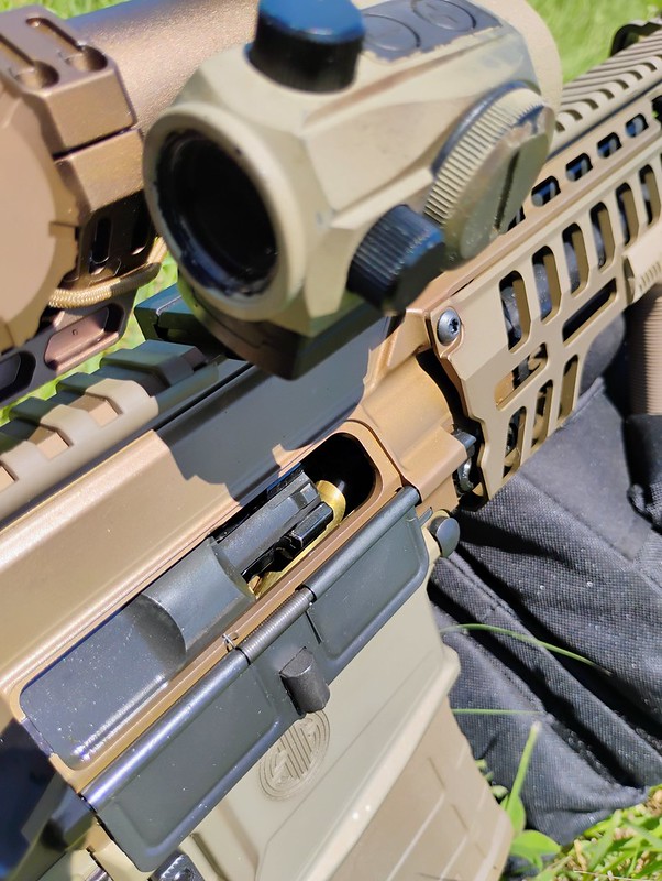

I finally got the replacement Spear out to the range on Wednesday this week. Didn’t put a lot of rounds through it. (80-100) because of the heat, but I didn’t have a single malfunction. It chugged right along through the Winchester/LC and PMC I had. Didn’t have an opportunity to shoot much for accuracy, but hopefully I can do that at a future range trip.
