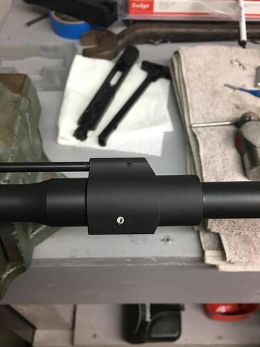

So I’m at the stage in my build where I am assembling the upper -specifically the gas block.
One of my barrels is a LaRue* Stealth which has three dimples and I have the matching gas block. Beefy.
Should I get this pinned? Thoughts? *sidenote: I am having an multi-month ongoing CS issue with them right now.
Another of my barrels is a Ballistic Advantage Hanson. Comes with a pinned gas block, but no dimples. Should I send it off to have it dimpled?
Lastly, I have a GMR barrel with no dimples or pins. I originally wanted a FSB install, but I can’t find someone who will do it because the barrel is nitride’d. Should I dimple & pin? On this one I am using a nitride low-pro Brownell’s gas block. Weird set spacing at .415.
What’s the thoughts on dimpling? Pinning? Is it a must? - All of these rifles could potentially be duty use.
How can I make sure the gas block is properly aligned without the barrel being dimpled? Can I do any of this work myself -I haven’t found anyone in the mid-Michigan area I trust anymore.

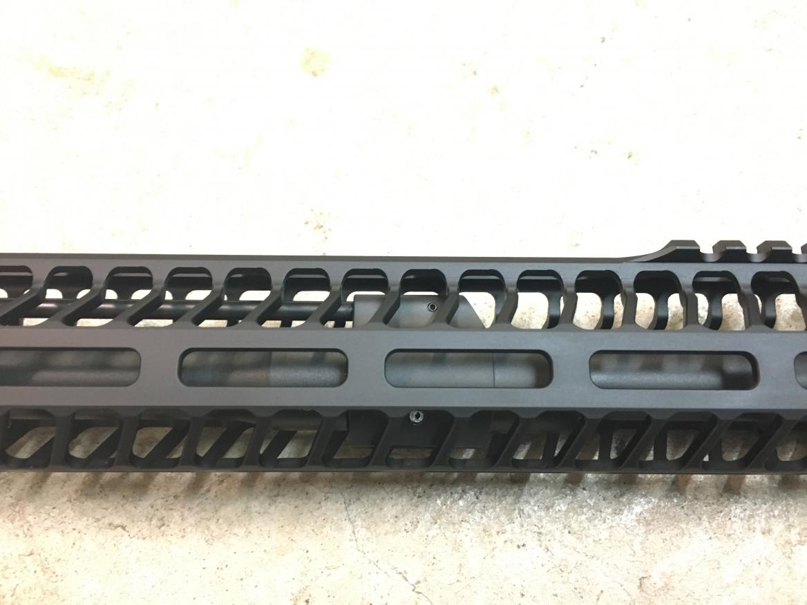

While I’m not the definitive authority on gas blocks, I’ve not ever seen a properly installed gas block set-screwed under a hand guard come loose. In fact, it’s difficult to take off some factory installed gas blocks such as BCM.
I used to pin mine on no matter what; and while it’s the most bomb-proof way to install it, it’s overkill.
All exposed gas blocks or FSBs need pinned, no exception.

Reference your original post - if the gas block is pinned it does not need to be dimpled, so that BA Hanson barrel should be good to go.

If you own a drill and bits then just buy a jig and dimple your own barrel, they cost less than $40. I paid $35 for my SLR dimple jig, on one side it lines up on your gas port hole so on the other side the dimples are drilled in the perfect spot.

On that LaRue Tactical Stealth barrel with their gas block, there is no need to pin it. Just use the supplied Loctite and you are good.

Just my opinion but pinned is better, always. Screws come loose, Loctite makes it less likely but not impossible.
Not saying “if it can come loose it will”, but I will say “if it can come loose it might”.
The good thing about a lo-pro GB is that it doesn’t need to be so elaborate as two tapered pins-- because you don’t have a 2 1/2" steel lever (front sight base) to attach. There’s no big lever in place to get bumped. many lo-pro GB’s will be well protected under the hand guard.
For me the set screws are there to hold it in place while I cross-pin it. A 1/8 or 3/16 split pin is adequate.
I pin all mine. Just too easy to do. Granted I dont taper-pin them I just use a coiled stainless roll pin I pick up from BRDEngineering. My go to lo-pro block is the SLR GB7-PIN with a pinning flat already on the block ready to go.
Rainier Extended .750 on a Spikes Optimum Profile Barrel
So if I get a BRD for SLR jig, do I need a drill press or a vise + hand drill?
Also, I emailed Jake Carlson of BRD and asked if it matters which dimpling jig I get if I only intend to drill one dimple -making sure it’s the same profile width. He replied, “No sir, all of the jigs do one dimple under the gas port.”
Ive only used a good drill, bit, vise, NO-MAR vise jaws, low drill speed, patience and some cutting oil.
Yes, I would use a vice. Lots of dimple jigs out there, I use the SRL because I already had an SRL gas block and my SRL jig does two dimples not just one.
