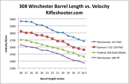

RifleShooter.com did a test whereby they shortened a barrel from 28 to 1`6.5 in 1in increments, test results
You should be able to extrapolate from that.
Final results averaged less than 25fps loss per inch. Count it as 30 to be safe and judge if it’s worthwhile or not.

Was familiar with those barrel length/velocity loss test-numbers, thanks - clearly the loss of velocity is a non-issue.

http://rifleshooter.com/2014/12/308-winchester-7-62x51mm-nato-barrel-length-versus-velocity-28-to-16-5/

Most of the “old school” reloading manuals usually suggest 25 ft/sec per inch of barrel for loads below 3,000 ft/sec and about 30 ft/sec for loads above 3,000 ft/sec.
As clearly shown by the test on the link someone provided that factory loads designed to work best in a 24" barrel had did their thing by 28".
