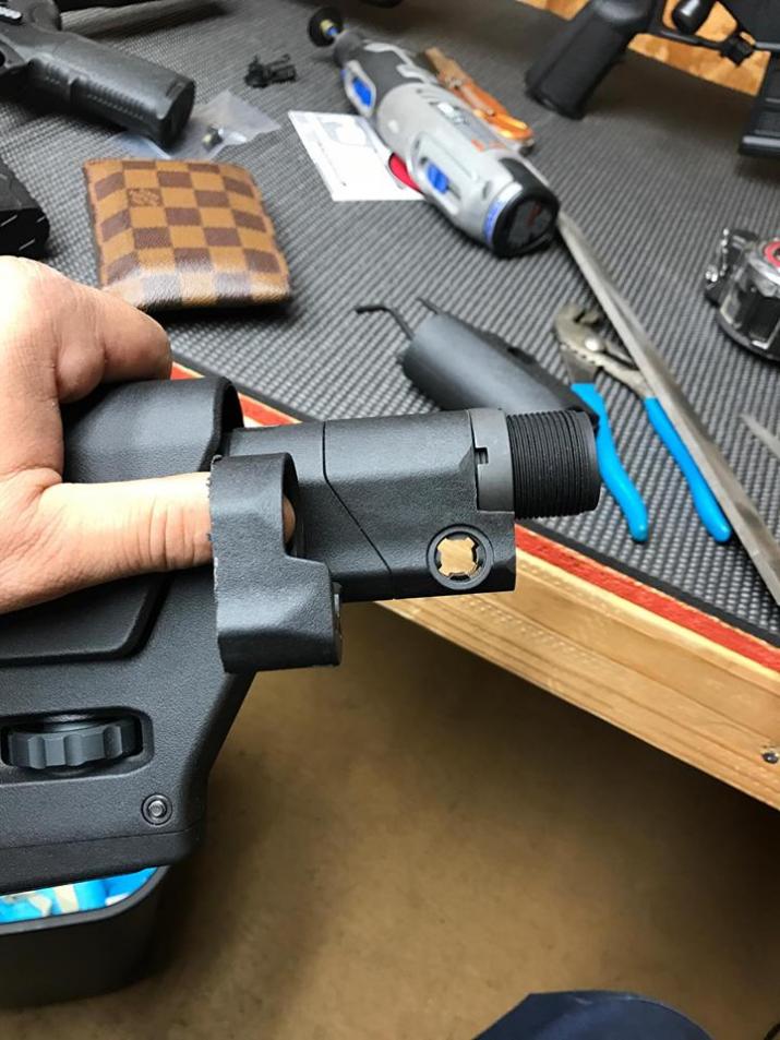

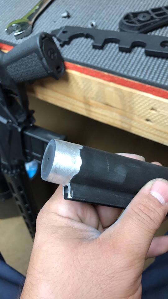

It is possible to modify the Gen 3 PRS stocks for a shorter length of pull when using a carbine receiver extension.
You need to cut the front of the PRS carbine tube adapter and reshaped it to look like the original, then modify the back end of the carbine buffer tube so that it can be completely inserted into the stock. For the carbine tube you need to cut off an inch of the bottom rail (see photo) and use a bench grinder to reduce the diameter a bit in that same 1" section.
Pics are borrowed from a friend:
A pic of the shortened stock on his RPR:
On an AR you would probably need to use a side charging upper to avoid any issues with charging handle interference.

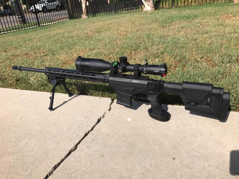

I recently purchased a Magpul PRS Gen 3 stock and installed it on my Ruger Precision Rifle. The measured length of pull was 15-1/8", which was too long for me. I contacted Magpul and was told an adapter shorter than the carbine adapter was not available. I performed the same procedure posted by Tx Aggie and was able to reduce the length of pull to 14". This made the stock useable for me.
The Magpul stock is definitely more comfortable than the OEM stock and if 14" length of pull works for you Tx Aggie’s modification is worth consideration.
