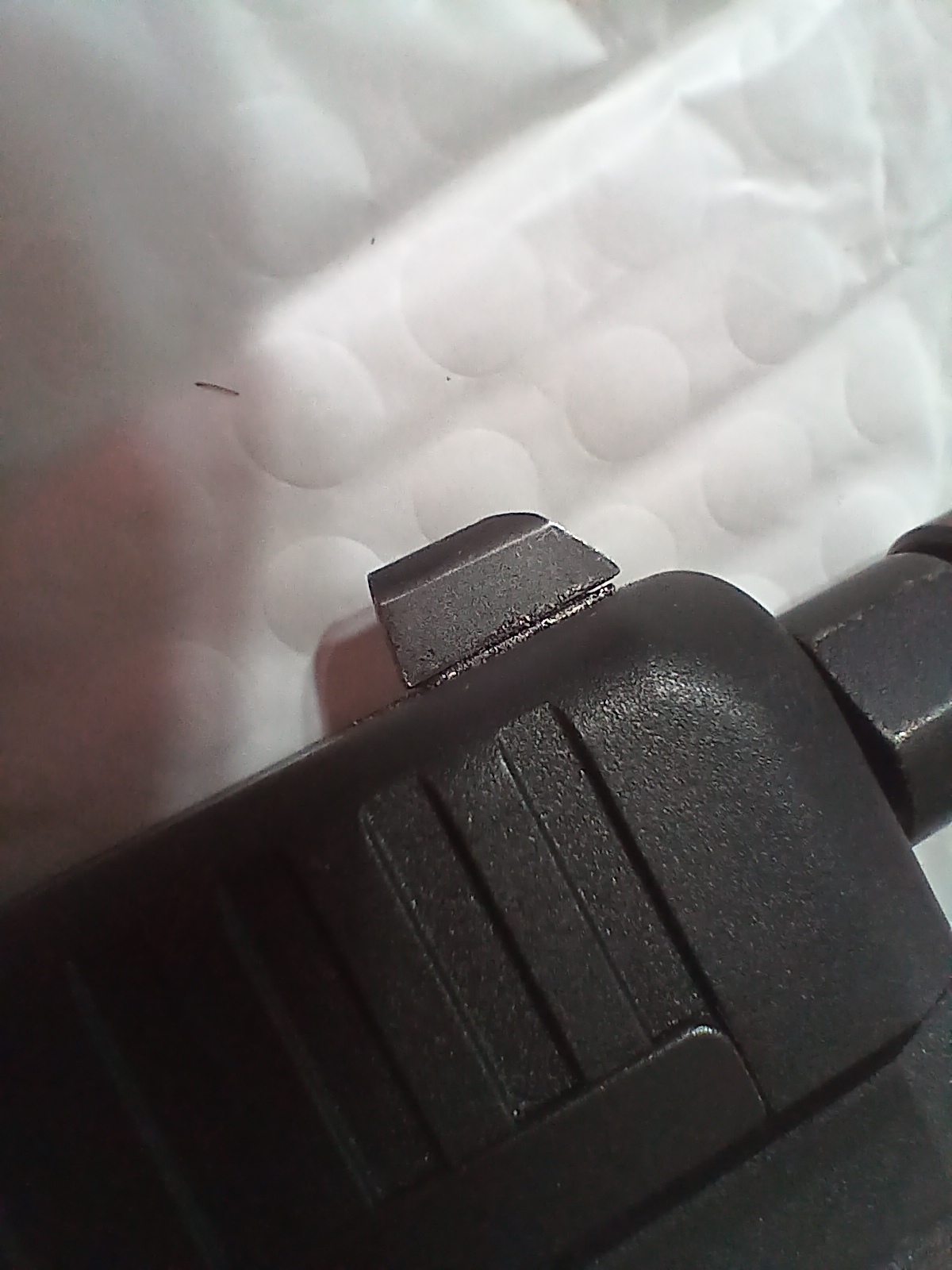

It was a bitch to get the shim over the front sight boss that i assume will be the case with other fronts since the XS fit as well in the Glock front sight hole as other brands, but are not at all oversized.
No apparent issues with screw length accomodating the shim. Presumably it will look more in place with Sevigny sights and some others. Finally got to shoot the combo Friday night and was happy it resulted in a much more useable/predictable POA/POI out to 25 yards.

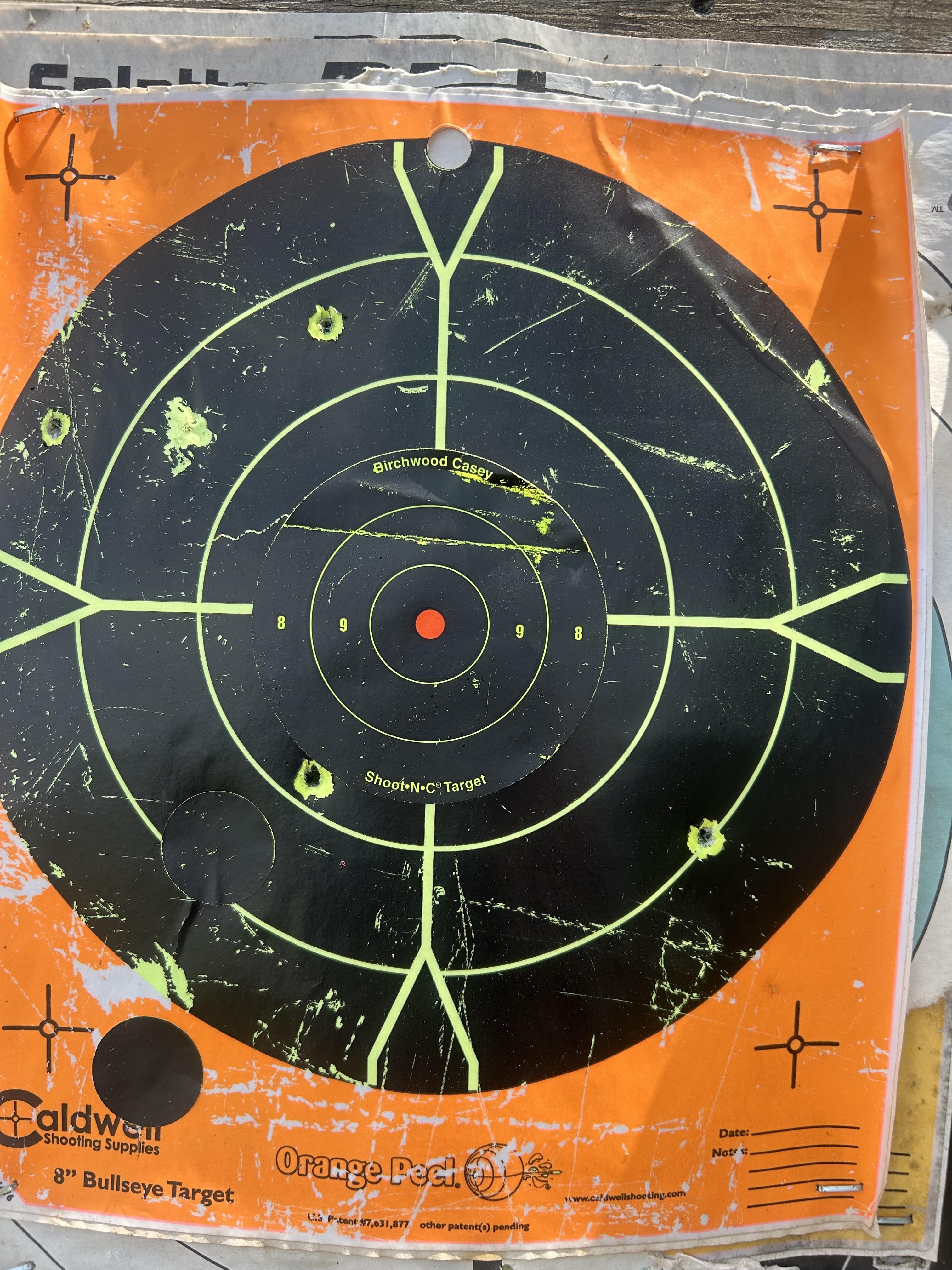

Just shot it and noticed my front sight is starting to lean pretty badly. Getting harder to hit steel at 75yds. Guess I’ll be buying a Dawson front at some point.
30 yds, CCI Clean 40gr. Don’t mind the poor marksmanship, just checking POI. I had the thought that maybe I get hits at distance because it’s high at 25, but that doesn’t seem to be the case.
At that distance using the ammo i shot i would be lucky to get any in the black while holding on the center red dot.
If it weren’t for the Harrell/Plinkster reviews(who were/are much better shots than i am) i would have went with me screwing up as the problem, but apparently some do hit high.
Yeah, I saw one of the youtubers you posted and the dude was having problems that didn’t seem like marksmanship errors. I don’t doubt there’s a problem.

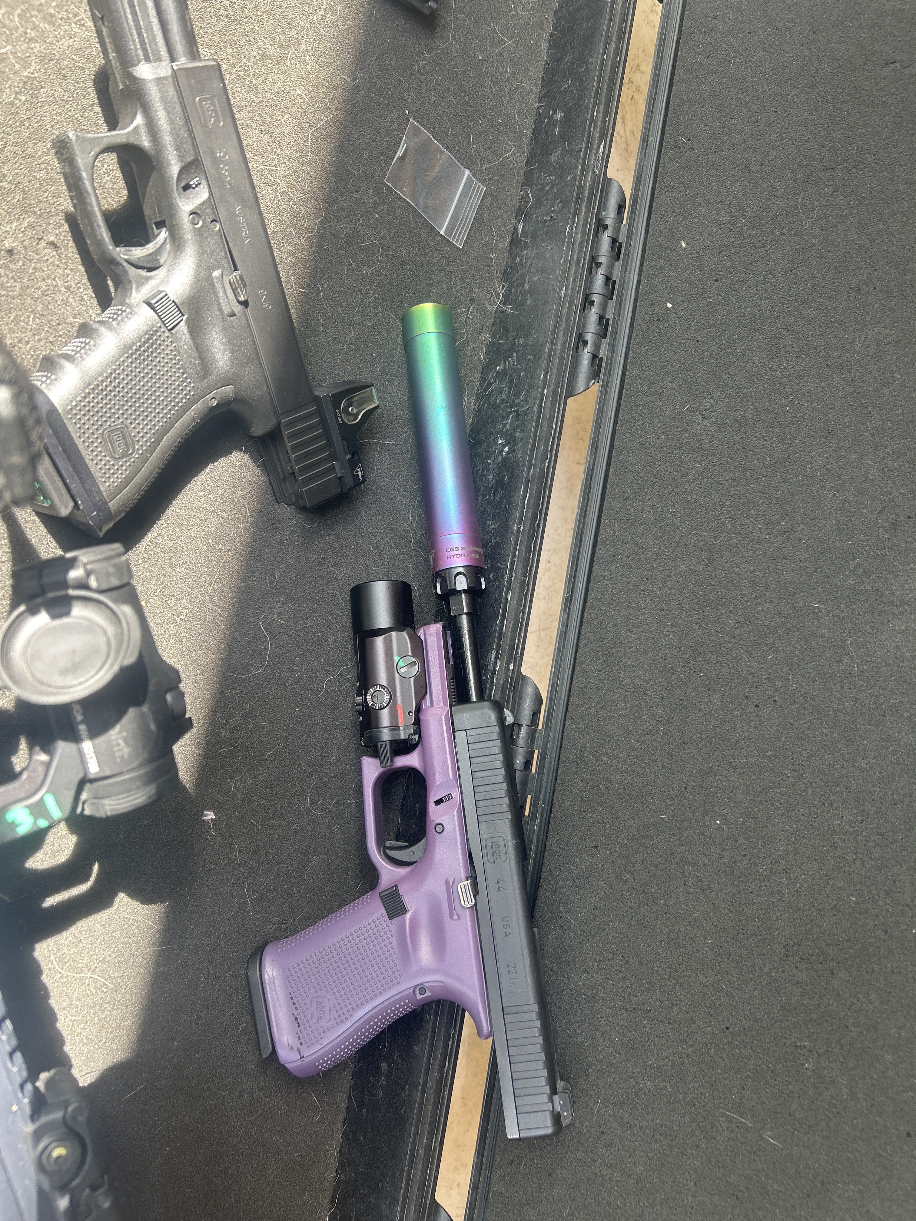

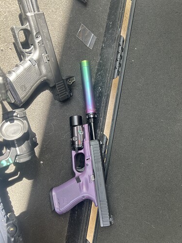

Hadn’t seen a purple(if the color is coming throufg right) before or a rainbow coated can before. Neat combo!
Speaking of the Glock 44…
I would like to think this was some weird April Fool’s meme, but watched the video where another dude did this kind of thing at a gun shop so apparently in to the palm dry firing has a small, but dedicated, group of practitioners.
It is, in fact a purple frame with a rainbow anodized can. They were out of plain black when I bought it. CGS Hydra SS…I’ve got one on my pink/purple camo painted M&P 15-22, too. That one was originally owned by my ex-wife.
Chicks love them and ask for them by name when packing for the range.
