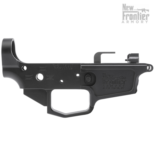

Hey all,
Been thinking about a 9mm build for a while and finally ordered a New Frontier Armory C-5 lower (accepts MP-5 magazines). I’ll be adding their upper receiver for compatibility with the mags but after that, I don’t know squat. Some I am wondering what are the go to parts as far BCG, buffer, spring, receiver extension and barrel? The build will be a pistol configuration with either a SBA3 or Tail Hook Mod 1.

From what I have gleaned elsewhere, the FM stuff is decent but temperamental with the NFA C5 lower. I’ll stick with the NFA assembled upper (just the upper, not group) as they are local and I can get support.
