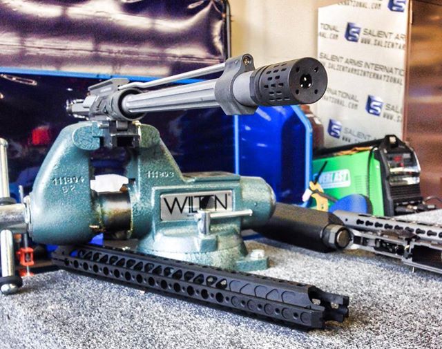

I searched but couldn’t find anything about this. Salient Arms has been posting a lot about their AR15s built with a “full rifle length gas system on a 16 inch total LVOA rail (14.5 barrel + pinned/welded comp). All of which makes for an extremely soft shooting weapon with reduced muzzle flash.”
Images from Salient Arms’ Facebook page:
Without commenting on the manufacturer, has anyone experimented with this combination? If you had a bunch of rifles or rifle barrels that you wanted to convert to carbines it might be worth considering but other than that, is it feasible? 18 inch barrels with a rife gas system seem to run ok but a 16" or 14.5"? Not much dwell time.

Nice vise! GH
