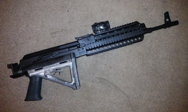

heres the pics, sorry that it took so long to post. does anybody see anything wrong?
Nothing jumps out at me. But here’s an idea… strip your bolt. IIRC the 7.62 Saigas have a spring loaded bolt. In one of your pics, the firing pin appears all the way forward. Which means it could have an obstruction in the firing pin channel, and could potentially be the cause of your light primer strikes. There could be a tiny chunk of steel that fell in there during your conversion, or even from the factory.
Strip that bolt down to it’s smallest parts. Remove the extractor and spring, and clean that bad boy. Make sure to really clean out the firing pin channel with a long q-tip, or even a coat hanger bent straight. Whatever will help remove any potential obstruction (it may even be stray factory paint). That’s what I would do first.
If for some reason the FP in this Saiga is not spring loaded, my advice would remain the same. At least as this first step.
Hmm, nothing jumping out at me (great pictures, btw).
I see you have a plate in to hold the FCG pins. How is that hammer pin? Looks like it’s sticking out a tad. Is it able to be pushed in more?

I ordered a JTE Performance Power Hammer Spring /Main Spring just for a little peace of mind. I’ll be stripping the bolt sometime this weekend and give everything a very thorough cleaning. All the pins including the FCG pin look good and there are no signs of obstruction anywhere but who knows. The hammer pin can be pushed in/out and has very little play with the weapon unloaded. I’m hoping that it was only the reloaded cartridges that I purchased at the gunshop and not the AK. Thanks for the insight peoples, wish me luck! :smiley:

Also, good call on the hammer pin, although it does at first glance look like it’s properly retained by the plate. Having the hammer pin come out a bit would possibly cause the OP’s problem, as you have noted, but my guess is it wouldn’t have been an issue until its 5mm end came all the way out and really deadlined the gun. The OP’s observation that the problem is inconsistent leads me to suspect a firing pin channel obstruction, but hard to know for sure from this vantage point.

Something about the firing pin does seem a bit off AFA when the bolt and pin are forward.
Almost like its too flush with the tail of the bolt, although it could just be due to there being no cartridge in the chamber to stop it moving so far into ther bolt bore.
