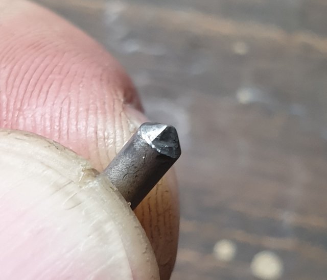

This is an “upgraded” selector detent that comes with the BAD-CASS.
Selector was getting mushy in “Safe” and I trucked on. I eventually started finding my rifle on “Fire” after it was jostled around.

I had the exact same thing happen with a BAD-CASS detent as well. It was ground into a chisel shape just like your picture.
