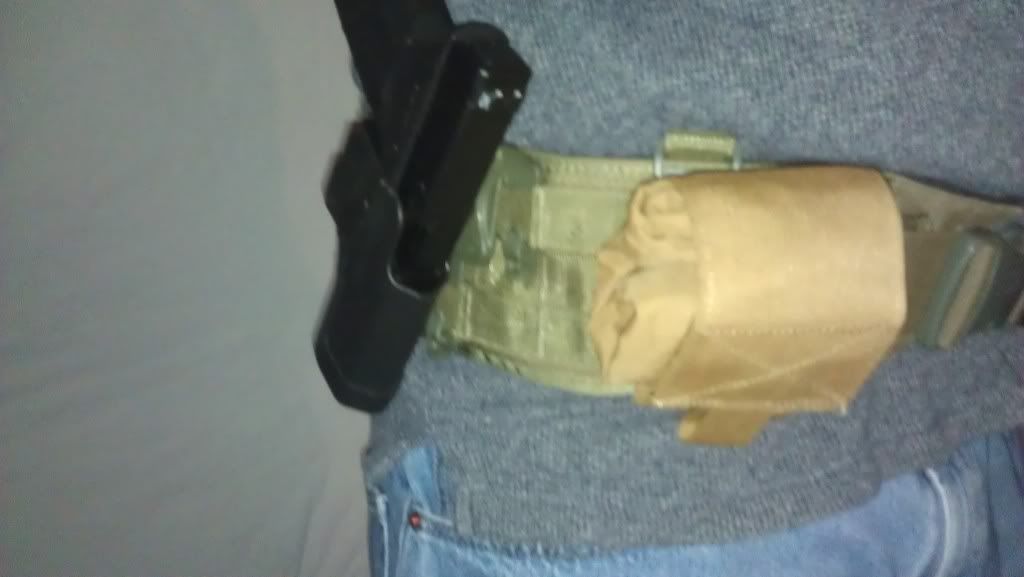

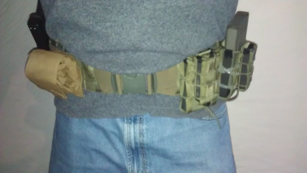

I measured the belt and from the top of the inner belt to the bottom of the mollebelt is 3 inches. I need to figure out which ubl can do that. The good thing is this would drop the gun and allow for a more natural draw. The bad thing with the gun lower is that it will dig into my big but and may be hard to draw grow when sitting. :smiley: Here is some pics of my current setup. You can see how high up the gun rides.
This setup allows a good draw even while sitting.
