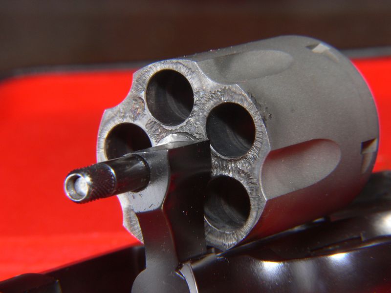

The problem is with the titanium .357 guns not the .38s, the .38s don’t have the warning printed on the barrel shroud. It’s flame cutting/erosion of the titanium cylinder face due to the light bullet exiting the cylinder too quickly. I can also happen if you scrub the powder off the cylinder face too harshly and remove the protective coating. I’ve never seen a titanium .38 exhibit this issue.
Here’s a pic of what can happen with light .357s…
