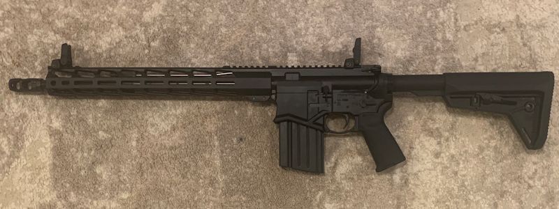

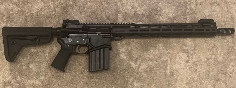

Observations from owning and shooting an SFAR Model 5611, 20” barrel. Ammunition used: Hornady TAP 80965 the 168 gr A-MAX. Shooting distance of 106 yards measured using SIG Kilo 2400 ABS range finder. Scope is Vortex PST2 3-15, FFP MOA and scope base is a Vortex one piece mount. Rifle, scope and mount weigh 9.2 lbs. Weather was sunny, 89 degrees, humidity 70%, and pressure 30.12.
Fired 60 rounds to zero, determine accuracy and as part of the 200 round break-in. Gas left on setting 3. Average velocity was 2630 using LabRadar. Accuracy was MOA or better. I am limiting factor on accuracy (76 and onset of essential tremors).
I experienced 3 failures to eject. When they occurred I believe I was not firmly holding the rifle - similar to cycling problems with a 1911 with a weak grip (limp wristing). Didn’t see damage to brass, however, I didn’t inspect every piece of brass.
I am happy with this rifle but will install a LimbSaver recoil pad and replace the charging handle with an Aero Precision Ambidextrous Handle.
