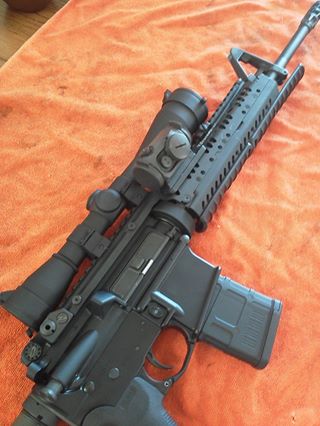

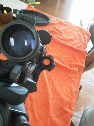

I direct mounted a T1 to a casv-s to back up a leupold M8 6x42.
I can’t say how I like it because I only finished building this rifle yesterday. I laser bore sighted her but haven’t shot her yet.
I’m function testing her at our range in about 45 minutes so I’ll report back.
