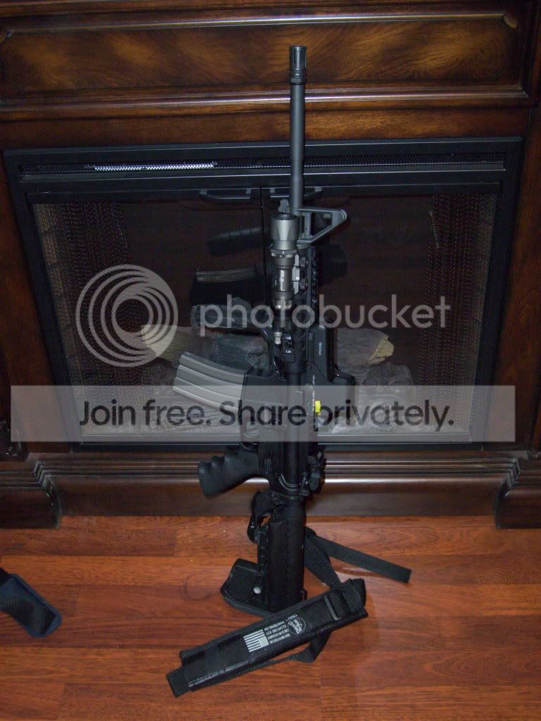

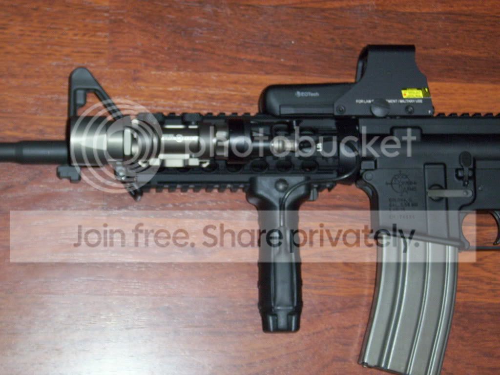

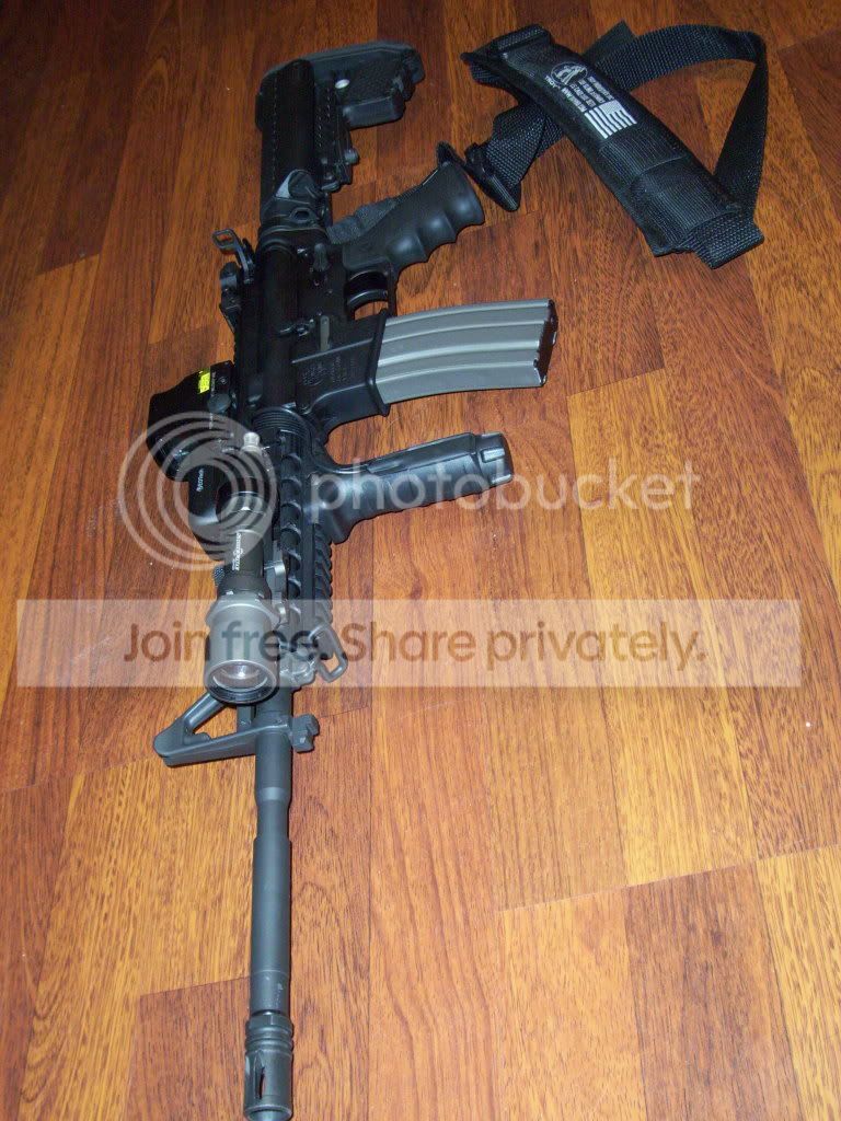

This was my first build, Started with a RRA Entry Tactical
Troy MRF-DI Handguards
Troy One Point Sling
Troy BUIS
VLTOR EMOD
M.I. #13 Sling Adapter Plate
EO Tech 512
Surefire M951 Weaponlight
TangoDown QD VFG
Badger Tac-Latch
Hogue Grip
Troy BUIS
VLTOR EMOD
EO Tech 512
TangoDown QD VFG
Badger Tac-Latch
Hogue Grip
