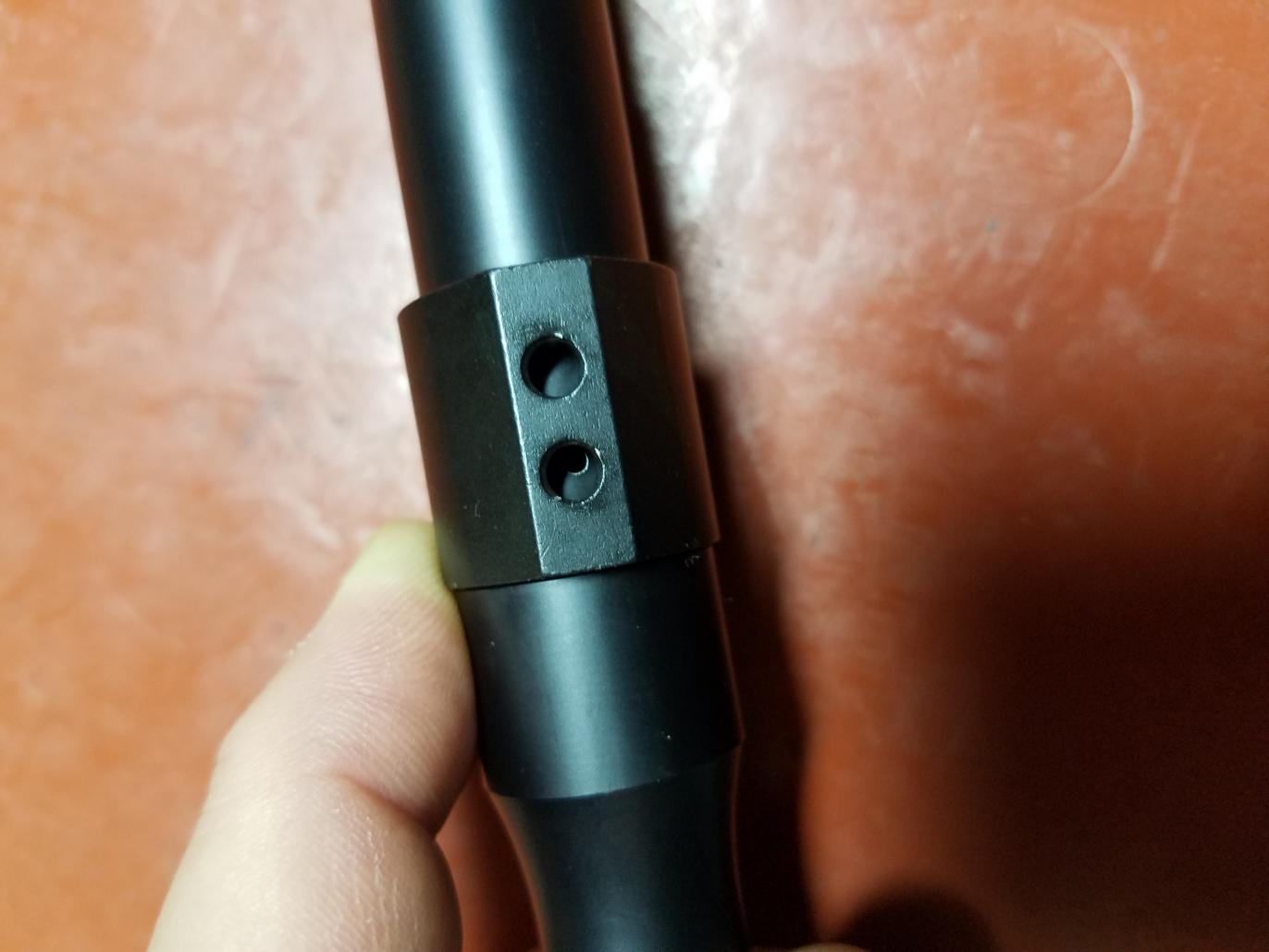

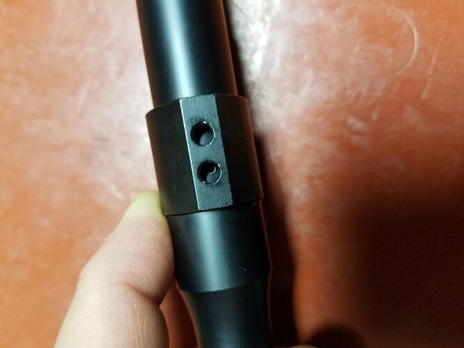

… and decided to give Rosco’s 11.5" Bloodline barrel a try. I keep seeing good reviews online about these guys (namely Garand Thumbs reviews among others) and their prices are good. Stock is hard to get so when I finally found the barrel in stock I placed my order. One of the things I though I’d like is the fact they dimple the lower barrel for ease of gas block alignment/install.

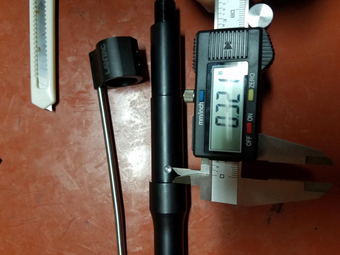

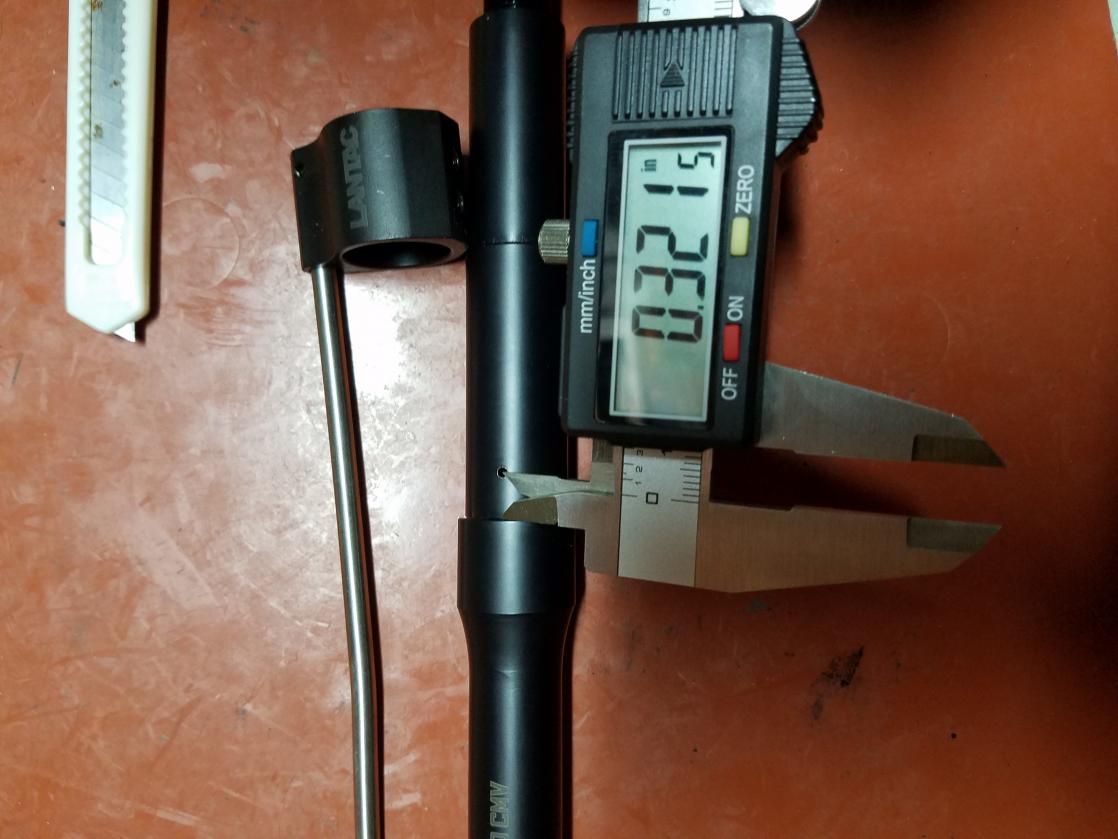

I like to test fit and measure all my parts before installing and noticed that the location of the barrel dimple for the gas block was 0.295" which is inline w/spec and perfectly matches my Lantac Gas block. However, when measuring the location of the gas port hole in the barrel it is ~ 0.322" back from the shoulder of the barrel. Do you guys think this will give me any troubles? I know the Gas Block and Tube opening are much larger than the gas port hole and it may not be an issue… but I’d also like to not have any issues after getting this all assembled and test firing it. Hopefully that makes sense. What do you guys think?
Not trying to slander or flame Rosco as they asked me to send the barrel back for inspection after seeing my pics. They also offered a refund or I can wait 2+ more weeks for another barrel to be in stock and ship out to me… which takes another week+ So I’d be looking at nearly another month to get another barrel from them. Not sure it’s worth the headache to be honest. :confused:

No problem. If the barrel wasn’t already dimpled I’d just make sure my gas block was positioned properly and then dimple the bottom of the barrel myself. However since this barrel is already dimpled I think they screwed up… in that the dimple should align w/the gas port on the top of the barrel. I think I’ll just send it back and won’t be giving anymore of my $$ to Rosco and just try and find another 11.5" barrel for this build.
I guess my main question was whether or not it was critical for the rifle/pistol to function if the gas port hole was not centered under the gas block tube hole… if that makes sense?
It will depend on the specs of your block. Based on the differences of almost .025 exactly, I don’t know if it really is an error, hopefully they will confirm. But, as a consumer, your comfort is the only piece that matters for higher value purchases. Sounds like Rosco will take good care of your either which way you go.
Nonetheless, I have faith that that small of a difference will be negligible and your gasblock should accommodate that without issue. Souds like most LO-PRO blocks are cut with their inner port hole at 10-32s. Seeing as lantacs are 10/32 set screws, I am inclined to believe your gas block port is as well.
That should be able to handle a .025 fluctuation without issue.
So I heard back f/ a Rosco rep saying that based on the pics it appears the barrel is out of spec. I guess I’ll send it back and figure out how to proceed from here. Not sure I want to wait another month +/- to get another barrel from Rosco or just try something different. :confused:

Rosco has been great to deal with so far… I’m sending my barrel back tomorrow and hope to get a report on what’s wrong. I’d really love to know the measurements on your gas port location (space between the shoulder and the hole) to compare it with mine. Everything else on the barrel looked great. Fit/Finish and nice packaging. Had they not pre-dimpled the underside of the barrel I would have used this one and got the ports lined up and dimpled the barrel myself. Hopefully your barrel is spot on and mine was an anomaly!
Just put the calipers on the barrel… dimple is .3025 from outside edge of shoulder to approx center of dimple. Gas port is at .3140… give or take a thou or two. I assume this is close enough to be in spec?

Update: Heard back f/ Rosco and the barrel dimple was out of spec. Had the barrel not been dimpled f/Rosco it would’ve been a non-issue and I would have spaced the gas block appropriately and then dimpled the barrel myself. The Rosco rep said this one should have never left their factory. All in all, I’d do business w/ Rosco again given their ‘internet’ & ‘social media’ good reputation and how they treated me was spectacular.
