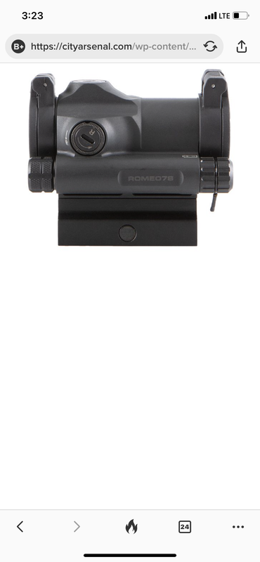

Romeo 7s mount footprint?
Can anyone confirm whether this is a T1/T2 footprint?
Sure looks like it to me.
Thank you sir!
It is, I have a couple and one is mounted to an ADM T1/T2 Mount.

The optic in question is Romeo 7s, which is much more compact then the original Romeo 7. The Romeo 7 looks to be a Comp m4 clone, where the Romeo 7s looks to be a Comp m5s clone.
From what I gather, yes the Romeo 7 uses the Comp m4 mounting footprint, but the Romeo 7s uses the micro/comp m5 footprint.
I’m just wondering where the Romeo 7s height will be at, if I went with the comp m5s mount vs the T-1 mount.

The Sig mount has an obvious differential due to the optic body, at least compared to the ADM lower 1/3 mount. It’s similar to the height differences when comparing an Aimpoint T1/T2 body vs a Holosun Micro body.
Scalarworks might be able to let you know for sure on using the Sig 7s vs Aimpoint Comp M5s.
Thanks for the image. So if I wanted to use a Vortex micro 3x in conjunction, which Scalarworks mount would line the 7s up? I’m pretty sure the Vortex has a 1/3 lower mount. The one I have lines up perfectly with the AEMS at least.
I’m planning to order another 3x after Christmas, and Just ordered the Romeo 7s today.
I would really like to get the right Scalarworks mount height, the first time.
