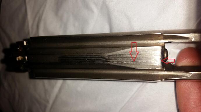

Anyone have experience with Rguns nickel boron 5.56 bolt carrier groups?

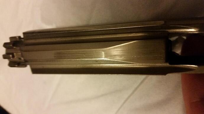

I bought one last year from Aim Surplus that I only recently started using. I’ve used it for about 400 rounds (high estimate) and noticed that there is wear on the bottom of the bolt that can be felt with you finger nail. Upon a closer look, the bolt’s finish appears to be flaking off in the magazine catch area. See images below.
This is on an all new rifle that briefly used a standard phosphate bolt carrier group. The previous bolt showed no signs of similar wear.
I can’t see how this is normal. Isn’t the NiB finish supposed to be one of the better, stronger, semi-self-lubricating finishes? At the time of purchase the rguns Nib bcg’s had good reviews. Looking now I’ve noticed a few complaints, but not like this.
Anyone have similar issues with the Rguns Nib bolt carriers?
I don’t suppose other NiB BCG (Spikes) have the same issues?

Rguns is a trash vendor. NiB or any finish for that matter is only as good as the people doing the work.
Rguns reputation is pretty crappy. I’m no longer like the idea of NiB anywhere carbon can accumulate… let alone poorly done NiB.

Some companies that apply NiB do not post heat treat. That NiB is only around 53-55 rockwell. Post heat treated NiB is around 70 rockwell.
Also if the bolt goes through gas carburizing but does not get a bead blast after the NiB will not stick to the steel. The residue left from the carburizing prevents good adhesion. Dirt and oil even coolant residue from a CNC machine can prevent adhesion.

Is it even worth having the nickel boron finish then, even on a better quality piece like Spike’s? Or just go with a high quality phosphate finish?

I sent AIM Surplus an email about this including pics and here is the response I got “Sir, I hate to hear this. This is the first I have heard of this issue with an RGUNS BCG. Unfortunately we do not carry these anymore. You will need to get in touch with RGUNS about getting that replaced. Here is their contact information. Thanks, Joshua”
Based off some other threads I’ve found I’m not the only one with Rguns bolt issues that has contacted AIM, so the fact that they straight up lied to me kind of has me pretty PO’d. I’ve spent quite a bit of cash there in the past 5 years so I’m not a happy camper.

NiB is a carbon magnet. The bolt I broke looked like a GI bolt because the porous surface of NiB just held carbon like velcro.

NiB is very slick to the touch, but is very porous on a microscopic level. MarkMs bolt was black, but still very slick (and slightly hydrophobic).
If you have anything plated, have it done by someone who knows what they are doing. Many people think they do, but (as we can see), they don’t - or their QA measures suck.
Flaking plating = complete failure. Like anything else-buy quality and avoid issues.
