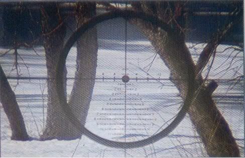

Reticle at 4X. (Taken from "Book of AR15.).

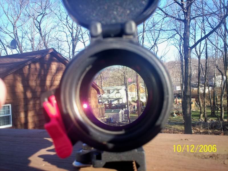

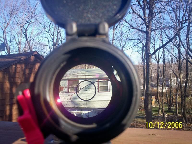

Here are some pics. The reticle didn’t come out that well, especially on 4x.
1x
4x

It seems bright outside in the pics, the retitcle looks ok in the pic. I see what you mean about the hold over portion not being “visible” in the 1x.

Yep, when it is on 1x, the holdovers are practically impossible to see, which isn’t a bad thing at all. Everything kind of clears up and when you zoom it out to 4x, the “Christmas Tree” shows up. I really like the concept.
