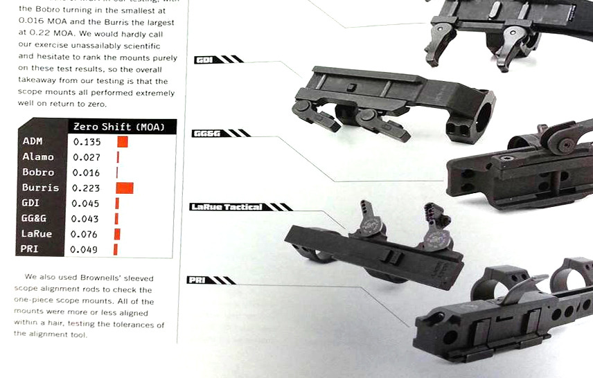

Easy answer for that one, check out the below. The results speak for themselves after actual testing, and not blown up paid for shilling from a manufacturer.
It should be pointed out the below are all QD mounts, and the better of them pretty clearly stand out. If you are looking for a non-QD which you can tighten via t-wrench, KAC has been tested by the military and come out on top, but that was years ago and not include the G mounts. I should also point out that SPUHR is fantastic from everything I’ve done and seen first hands with their mounts, including QD and fixed.
