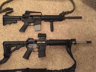

726889D1-B010-4CF7-B436-C7DA0374EC1E.jpg Dedicated 22 M4gery

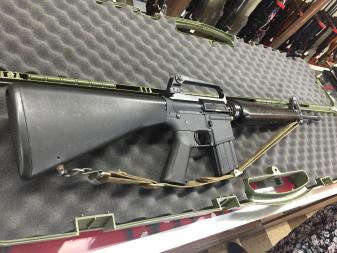

0F996130-F2E7-41FB-BCDE-026CDE0ABC1A.jpg. 1960s Colt SP1/604 Dedicated 22 Retro Build

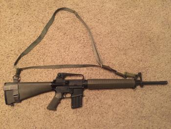

2BFE9115-DE12-4253-8F18-889874B48086.jpg. M16A2NM Dedicated 22 Build
Mine is a 604 series clone. Actually, it Was built with a surplus 604 upper, A1 barrel, Type D buttstock and A1 furniture and using a CMMG conversion kit. When the ejection port cover is closed and the magazine is closed, you can’t tell it apart from my 5.56mm 604 build. When I built it, I didn’t want the gas blowing back into the bolt from the gas tube so originally I was going to leave it off. However, that left the hand guard to twist since the front flange is held in place by the gas tube running through the hole. My solution was to grab an old gas tube out of the DRMO box, cut it down to a stub then instal it upside down in order to seal off the gas hole in the barrel entirely is it wasn’t needed and would keep fouling for-or blowing out over the top of the barrel under the hand guards. It’s actually been a pretty good bunny buster as well as a plonked and trainer for new shooters.

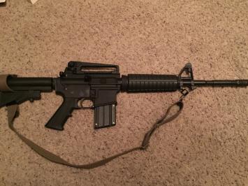

I have 6 of the CMMG 10 rounders in the traditional 20 round Straight body gray plastic bodies from 2010- 2014 timeframe ( no longer made) and 6 of the BDM gen1 10 rounders in a black plastic 20 round straight body too . These all work in my Dedicated 22 Retros ( But 5 of the CMMG have been converted for usage with the CMMG Bolt Hold open Actuater that allows usage of Bolt catch like Centerfire configuration but with Rimfire . 60559A77-4C17-43BB-ACA6-2FA03FB87159.jpg top Rifle has the CMMG BHOA and moded CMMG mag for usage with the CMMG SS 22 Conversion unit
