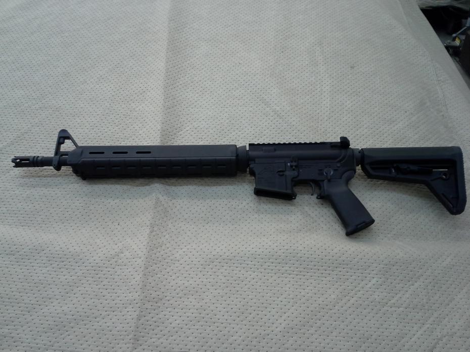

This is a mock dissipator I built using a mid-length gas 16" barrel and a clamp on FSP. I haven’t fired it yet, waiting for a couple of small parts to finish it off. The CAR type stock is a departure from the original dissipator also.
This is the barrel I used.
A 16" barrel with RLGS isn’t that bad actually, and is a very pleasant handling gun if balanced right.
I did a Colt Model 605A retro clone, using RLGS but a 15 3/4" barrel. It runs fine on XM193F in warm weather, but I haven’t shot it in extreme cold yet, which was the problem with the 605, as well as automatic fire.

Here is mine…
If you are trying to get a RELIABLE Rifle length gas on a 16’" Barrel, Buy a BCM 20 inch and send it to ADCO. They can cut it correctly and open up the gas port for proper cycling and dwell time
I want that ^ ^ ^
That is a totally awesome set up!
