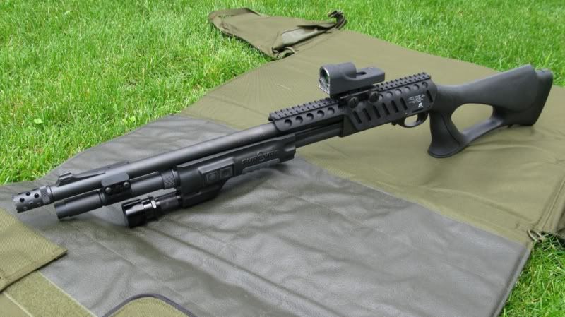

whose rail is that?
Knight’s, I have a mesa and a couple of others. The Knights is a very nice piece of gear.
