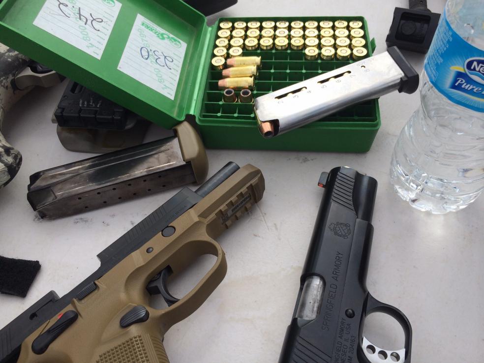

Markm loaded some SIERRA Hollow points for our 45’s. We tested a load today and it shot well. How many of you reloaders , do your own HD pistol ammo?
