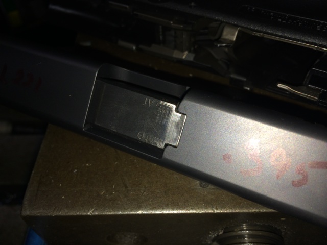

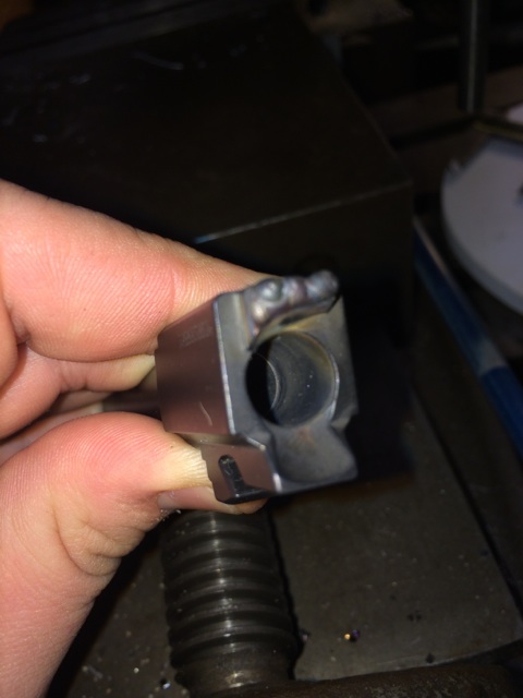

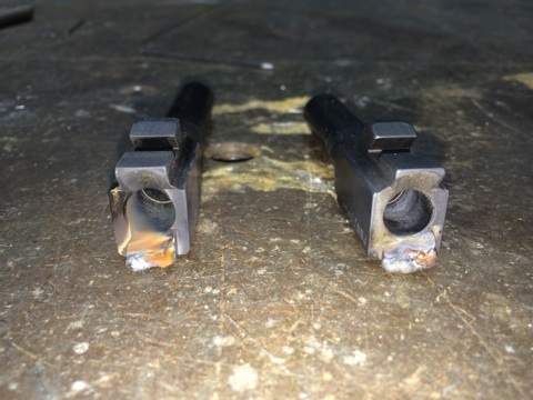

Awhile back there was a thread on here discussing the issues with Glock inaccuracy due to poor barrel fit which got me thinking about the old school method used in the 1970’s to help with making 1911’s more accurate. Basically the issue with Glock is the lock up is loose, to the point its sad. Its almost upsetting that Glock figures 4-5" groups at 25 yards is an acceptable thing. Back to my earlier comment on refitting the barrel to reduce this issue, back in the day it was accustom to lengthen the barrel hood by welding it then refitting it to the slide on 1911’s to help with lock up (tho on 1911’s there is more to it than just the hood length)
Here are the results of my experiment on my personal Gen4 G19 and a friends Gen3 G26. The results speak for themselves. I did not save my before target from my G19 so I made sure to document the G26 before and after to show the results that I was seeing. On the G19 test target you will note that there are a few stragglers in the 8 ring, this was due to finding the best way to bench the gun as i did not have a good rest at the time (that has since changed) The first time I shot the G19 at 20 yards it was 4" high and 3" right and after the refit there was less than 1" difference between 7 and 20 yards. I have put 1,650 rds through my G19 with no change in the results, including a 250 round abuse run, firing 50 rds as fast as I could drop a mag and load another one. Here are the results of the refits-

samuse-I checked the hardness of the barrel and found a donor material that was within the same Rockwell range, but I too am curious about the longevity of this. I don’t think a tighter hood would cause it to crack as I have it to the same specs as what I have fit Storm Lake barrels into Glock’s and they have been shot to Hell and back with no issues.

As to finding an equal filler, the hardness of the starting filler is fairly irrelevant to the finished weld hardness. The entire weld as well as the heat affected zone of the base material will be changed. Depending on conditions of the welding process as well as the materials involved you can get softer, harder, more brittle, less ductile, more susceptible to fractures or peening and a whole host of other property changes. Some changes may be more beneficial and some may be detrimental. Even the simple techniques used to weld it can make a huge difference, especially when welding harder and/or dissimilar metals (a little of both going on here). Any sort of inclusions in the weld or diffused gasses will also change the properties as well as president, post and interpass weld temps and processes.
