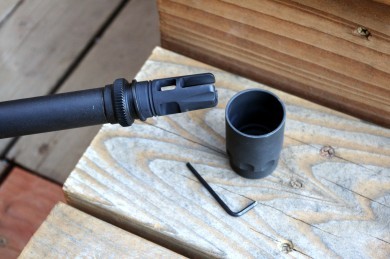

Up for discussion is the Ferfrans CQB Modular Muzzle Brake System (FF CQB System; U.S. and foreign patents pending)
Introduction
Muzzle brakes are valuable accessories due to the fact that they redirect propellant gas thereby mitigating felt recoil and muzzle movement which keeps shooter’s sights on target while firing multiple shots in rapid succession. The downside to muzzle brakes, however, is that it channels sound and expanding gasses sideways which may be extremely distracting for members of an entry team or fellow shooters at the range.
Thus, there is an unmet need for an effective muzzle brake that has minimal side blast or concussion and to redirect sound to the front of the shooter. As alluded to above, muzzle brakes are not typically used in CQB/urban environments due to undesired side concussion that could be distracting to entry team members shooting next to each other in a closed environment or when shooting prone. We’ve also heard of many complaints about how loud effective muzzle brakes are at indoor and even outdoor ranges.
The Modular Muzzle Device System
The FF CQB System meets the above-mentioned need for a muzzle brake that effectively mitigates felt recoil and muzzle movement while minimizing side blast/concussion and redirects sound to the front of the shooter. It is a two piece modular system that includes (1) a very effective high performance muzzle brake that has been extensively tested in full auto fire, and (2) a ported Concussion Reduction Device (CRD) that attaches to the FF Muzzle Brake using a quick detach mechanism. The CRD has strategically placed [u]side ports that allow the muzzle brake to retain its functionality [/u]as opposed to brake shields that cover the brake and negates its function.
Watch the following video to see how well the FF CQB System works:
[video=youtube_share;BH13VFhilTU]http://youtu.be/BH13VFhilTU[/video]
The side ports on the quick release CRD, shown below, allows some of the expanding gas to exit sideways. This allows the FF CQB System to act as a compensator to minimize lateral muzzle movement.
Thank you for watching.
Specs:
Brake Length: 2.28”
CRD Length 2.17”
CRD OD: 1.6”
Brake weight: 4 ounces
Brake + CRD weight: 10.4 ounces
Now available at Calegalmags

As mentioned in the original post, the CRD is different from a brake shield in that it has side ports that allow the brake to function as a compensator when the CRD is attached. So you’ll still get some benefit from running a brake without the side concussion.
The CRD idea was in the works long before the brake shields cam on market. It took a while to balance reduction in side concussion while maintaining muzzle control. There were many prototypes and this was the best “compromise” among all of them.
The CRD might maintain the leveling effect of a brake, but it doesn’t seem to preserve the other main purpose behind muzzle brakes. In both standing tests, it looks like the CRD significantly increases the rearward push of the recoil versus the brake alone. This is not unexpected, but it is something that will be mentioned by independent testers, so it makes sense to get in front of it with how this is marketed.
That is correct. You get a slight, straight to the rear push, with the CRD on (it’s more of a softer recoil feel, not the typical sharp kick).
It’s, of course, a compromise between reduction in side concussion versus recoil reduction. We believe we have found a balance of sufficient brake/ compensator functionality (leveling effect) and concussion reduction. That is why the CRD is quick release so when you want a full brake to minimize recoil, you can easily remove the CRD.
Check out the JTT Article on the CRD
Here’s a quote from the JTT article: “Muzzle brakes are great for keeping the muzzle of the firearm steady, helping the shooter to deliver faster follow-up shots. Unfortunately, they are also great at rattling the teeth of those around you and spraying debris everywhere when shot near the ground. The FF CQB System seeks to remedy this by providing what looks to be a no compromise muzzle brake that can be used to aid the shooter in controlling recoil and a shield that can be affixed over the muzzle brake to direct the sound and concussion forward, away from the shooter and those around the shooter.”

It’s a twist lock:
