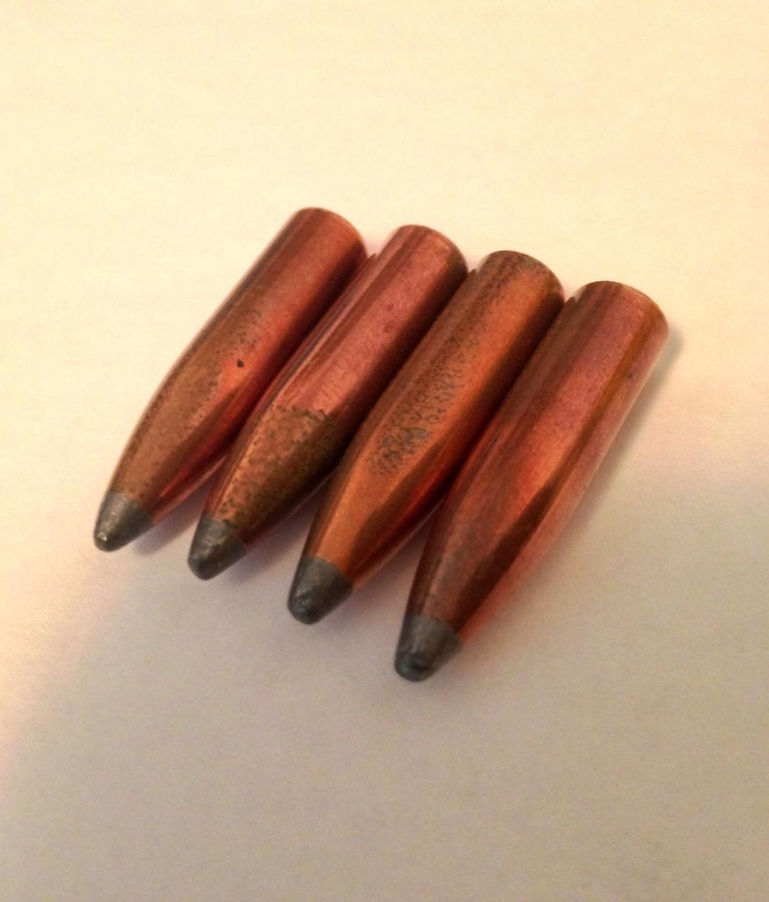

This week I will load a couple test rounds with the 200grn soft point, flat base bullets I’ve got. I think I’ll start off trying 9.8grns and 10grns of TrailBoss.
On a side note, has anyone ever loaded bullets that are tarnished? Did it affect bullet stability or accuracy? Some of these old bullets have some heavier tarnish on them that worries me slightly. You can just barely feel it, but for the most part they still feel smooth.
Anyone think I should be worried about it? I was thinking about tumbling them to see if that cleaned them up, thought that might mess up the soft point though.

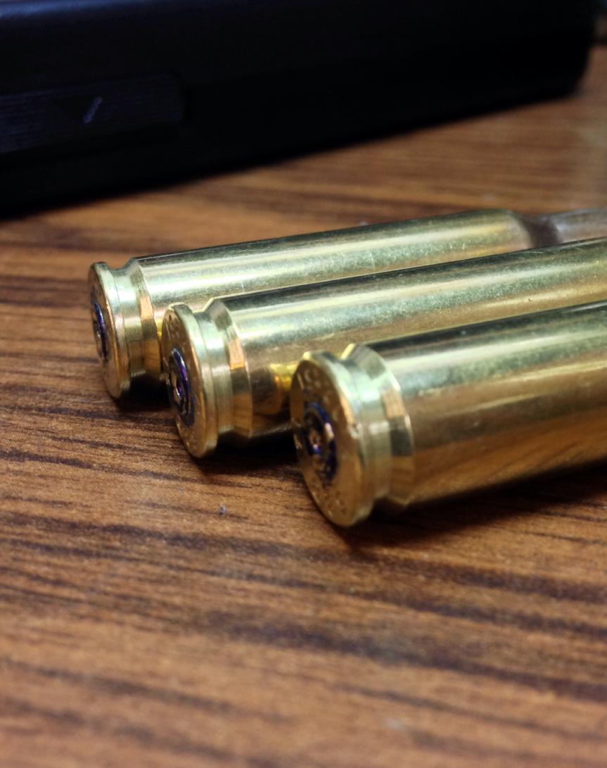

I shot a few more boxes of the S&B subsonic ammo and noticed that many of the primers had popped out of the case a little. I measured a few and they were about .013"-.017" out. It’s hard to see, but here is a picture.
Seems weird for a subsonic load to do this. Never had a primer do this with any other load in this gun, just the S&B subsonics. Any thoughts?
This is just a swag! but the cause of the popped primers might be “bridging” of the powder burn -that is caused by the flash from the primer igniting the powder at the flash hole and the bullet base at the same time, and causing a pressure spike- I did see a person loading subs and he would drop the charge into the case and then tear off a small bit of cotton ball and stuff it into the case to hold the powder charge at the flash hole to prevent this, he also showed some chrono readings and the SD’s and extreme spreads dropped when he used the cotton.
