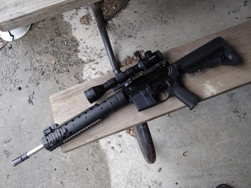

This is as “DMR/SPR” as I get.
BCM Lower/SSA-E/LMT SOPMOD stock/2.5-10X44 Vortex Viper
This is the URG: BCM SS410™ 16" Mid Length Upper Receiver Group with PRI Gen III 12"
Shoots great, very accurate @100yds
