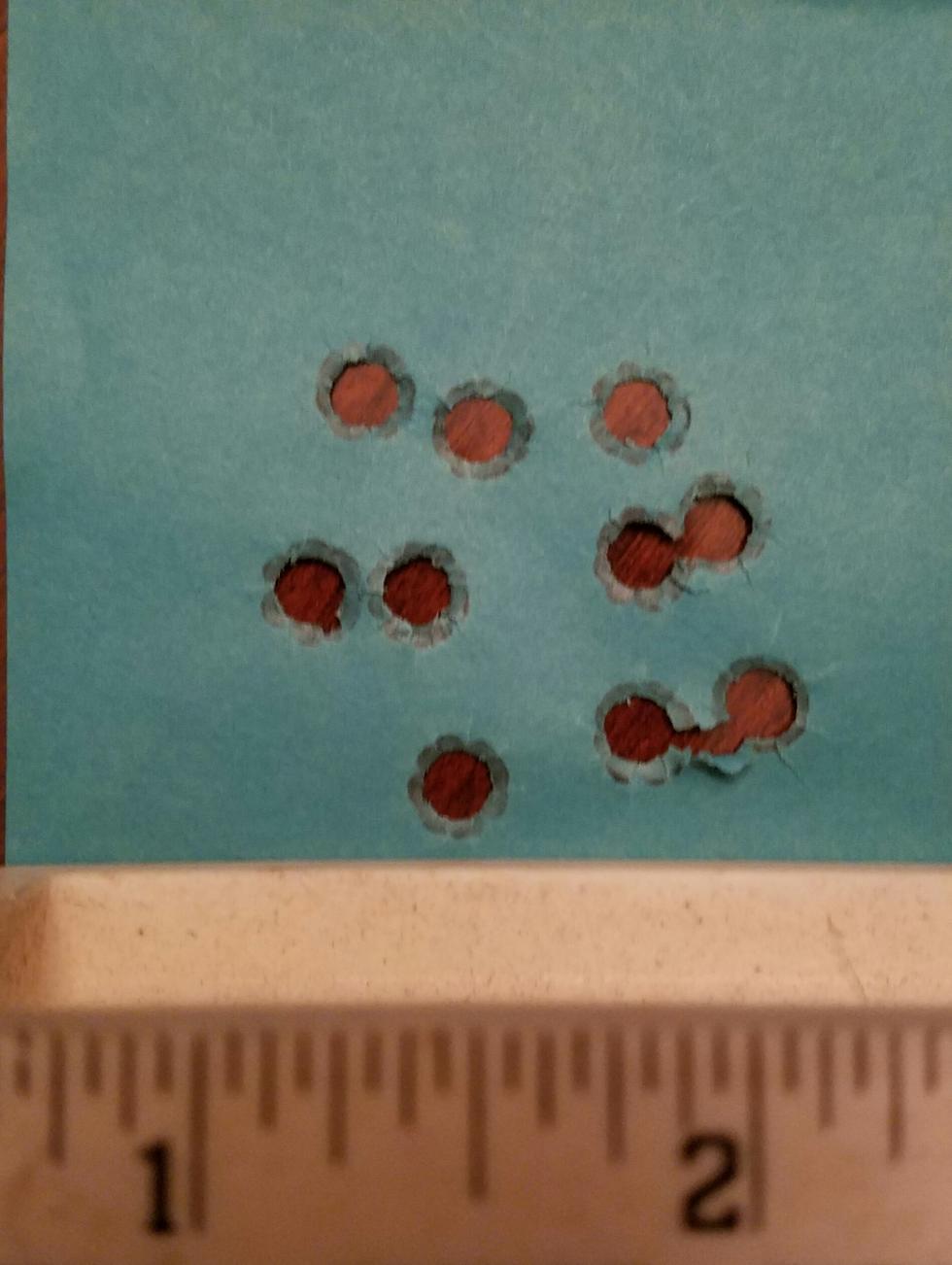

P9HST2 (lot manufactured in last 5 years I’d guess). G17 Gen 4 OEM nonthreaded barrel. 22.4 yds from muzzle (adjusts for angle). 10 shots in 30 seconds off bench. Target is ultra fancy 3x3 post-it note. I have never been a bullseye shooter so there is some error. Extreme spread of 1.6".
End result: Pretty happy with consistency in this lot. Would like to do the same with G2 9mm in the future.
