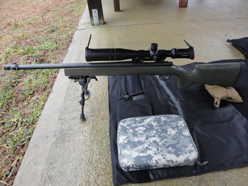

I’m having accuracy issues with my Remington 700. The specs of the rifle:
Remington 700 SPS-AAC Tactical
Bell and Carlson stock
EGW base
Burris Xtreme rings, extra low
Vortex 5-15x 44mm scope
Timney trigger
AAC muzzle brake (suppressor adaptor)
AAC SDN-6 suppressor
Harris swivel, notched bipod
Karsten cheek riser

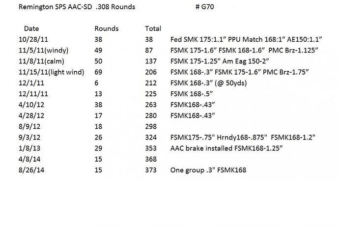

I included a picture of my incomplete round count records that includes some of the rifle’s performance. It started off not so great at 1-1.5" groups and I started making mods. I don’t have track of all the mods but after the stock upgrade it started shooting well to the tune of ~.43" groups. I’m not sure what changed but all of a sudden it started opening up the groups again. I suspected it might have been the installation of the AAC brake and after reading a recent accuracy issue thread I removed the brake (installed with shims) and reinstalled with less torque. I also disassembled rifle and reassembled with proper torques. Stock torqued to 50 in/lbs.

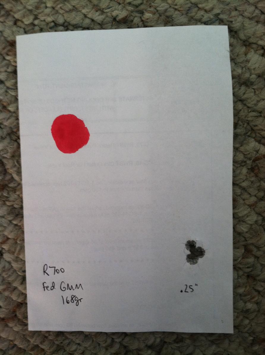

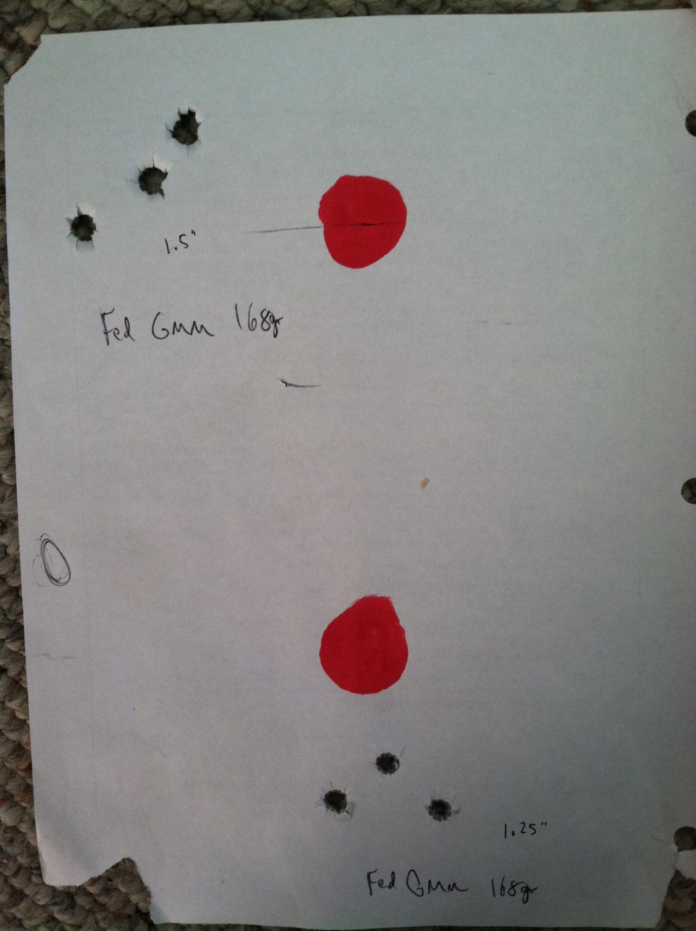

I went to the range recently and shot a few 1-1.5" groups and ONE outstanding group of about .25" all with Federal Gold Medal Match 168gr (SMK’s). This was all unsuppressed. The .25" group was shot somewhere in the middle of the bad groups. When I saw the groups opened up again I went over the entire rifle checking the tightness of all bolts including the base screws. Nothing was loose or appeared to have changed. I have swapped scopes and bases previously in search of the issue to no avail. The fact that I shot such a good single group makes this extremely confusing to me. Any help here is appreciated. I have included pics and screen shots for analysis.

I just don’t understand how it can shoot good groups sometimes and not others. And the good groups are a similar tight spread and the large groups remain similar in spread size. I apply a simlar technique each time I shoot: prone, shooting mat, loaded bipod, bag rest at rear of rifle.

Rig:
