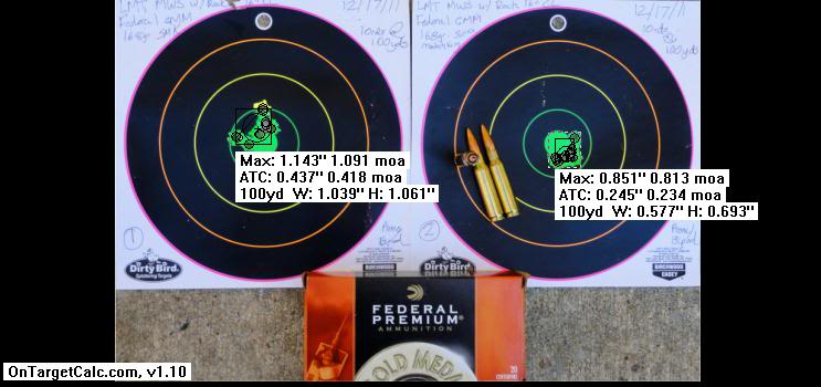

My LMT MWS 16" CL with Federal 168 grain GMM shoots 1-1’25 moa with a Nightforce NXS 3-15X50 scope on it. My LaRue OBR with the sam ammo but an NXS5.5-22 scope constantly shoots 0.7 to 0.5 moa. If you have the coin spend a save for the LaRue OBR or Predator you won’t be sorry.

Interestingly, the 16" CL LMT barrel shoots factory FGMM 168gr. better than all other factory loads I’ve tested to date as you can see in the linked thread below.

I own the LMT MWS 16" CL with PRS stock, NF 5.5-22X50 scope and Geissele SSA-E trigger. On good days it shoots 1-1.25 moa 5 shot 100 yard groups. I also own an 18" LaRue OBR with the PRS stock, same scope and trigger as the LMT. It consistently shoots well under 0.75 moa 5 shot 100 yard groups. I have never had a problem with either rifle. But if I could only have 1 of them it would be the LaRue OBR.

A good example of the kind of accuracy that can be achieved with an LMT CL barrel: https://www.m4carbine.net/showthread.php?80781-LMT-308-MWS-Pictures-show-us-your-setup&p=2198853#post2198853
