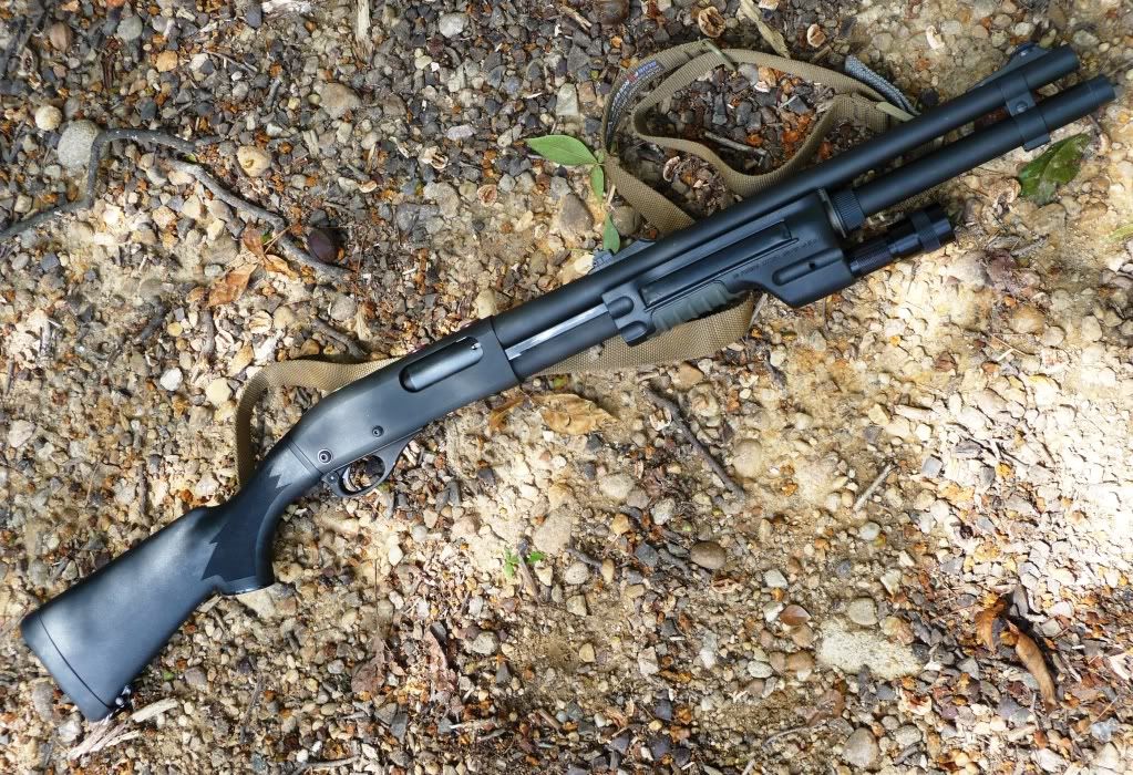

My 870 Police with a Speed Feed “youth” stock.

Speed feed youth model. With no shell holder

Thanks for the replies. Templar, are you planning on mounting the sling on the side of the stock or on the bottom swivel?
I’ll be getting a sling adapter for the rear of the buttstock which will allow me to mount it attaching to the left side vs. the bottom swivel.
I have two issues with mounting it at the front of the buttstock.
  1. The most serious…when transitioning to the left shoulder (I’m right handed), the position of the sling there prevented a spent shell from ejecting, tying up the gun. This happened twice in a shoot house at Rob Haught’s shotgun class.
  2. When slung and and without support from my hands, the shotgun would move on me more than I liked, and the buttstock would swing away from my body.
