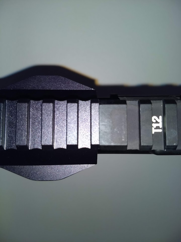

I recently bought a Premium CHF upper with M-Lok free float rail from Palmetto State Armory and the rail is slightly tilted towards the 1 o’clock position. See photo. Will this be an issue? The tilt is very slight so I think I should be able to zero the irons but I’m not sure if it will cause any other problems that would merit sending it back for repair. Was planning on mounting the Daniel Defense front and rear fixed sights and an aimpoint red dot.
Just loosen the rail slightly and correct it. I think that could affect your irons.
Typical PSA assembled by monkeys…loosen, align and tighten

OP, as has been stated: loosen, align and tighten. I would also contact CS via email and let them know of the issue. Or, if you’re a member of “the other site”, post it in their industry section and Josiah will get you taken care of.
Yep, easy DIY fix. Do that first before you zero it.

To the OP loosen align re-tighten if it really bothers you or makes upper not zero-able.
Loosen the handguard a little.
Install a scope etc which grabs both the upper rail and the handguard rail. Hopefully that will align the two.
Tighten handguard.
Remove / re-position optic.
Exactly. No big deal at all, just loosen, align, tighten.
I’m sure you know the trick of easy alignment; while it’s loose, bridge the gap with a scopemount, riser, etc.

Thanks everyone. I didn’t realize I could just loosen the rail myself via the screws on the rail, and the trick of bridging the receiver and rail using a sight (I used a carry handle) to hold it straight isn’t something I would have thought to do.
