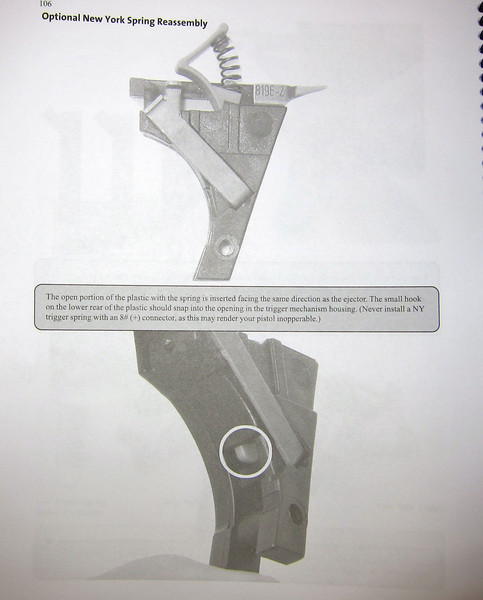

There is a curve to both the ejector housing and NY1 spring. They should match up (i.e. the open end of the NY1 spring assembly should face toward the muzzle). Also make sure you have the cross portion of the trigger bar on top of the NY1 spring.

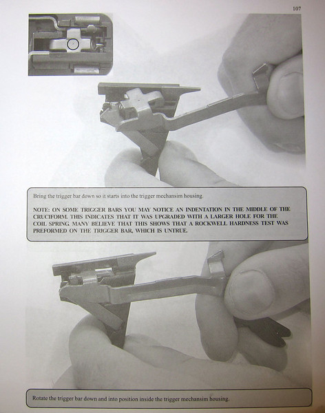

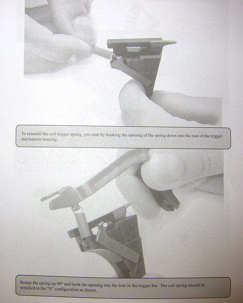

I took some pics of my Armorers manual so you can see if yours is installed like this.
The thing I was always taught was the curve of the NY Trigger matches the curve of the trigger housing and grip. Rounded part to the rear, the spring is facing forward.
It drops in, just like it is shown here:

As for your install, when you put the NY spring into the housing are you pushing it in until it clicks into place?
I did make sure that the ny1 was clicked into place and it was. It seems to be working fine now but I cant help but feel it could still have an issue since I didnt really change anything :fie:
