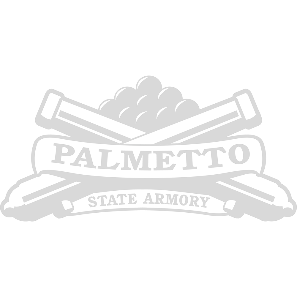

I recently found one of this type to have an undersize RP bore.
Would have been a cluster had I not attempted to dry-fit it for a function check, prior to driving the RP.
It had a “coarser” than typical, tactile (not tactical) surface on the paddle as pictured…
For reference, typical “finer” tactile paddle surface…
You’re referring to FA, correct?
No, this one in particular was shipped by PSA.
If you dry-fit the assembly as standard practice, using the correct diameter drill bit shank for a temp pivot, you will find this crap.
I tape the drill bit in place and let the roll pin chase it out as well.
My FA looks like the top one, and the noname one looks like the bottom one. I did not test fit the pin in first, but I will now. They could not be forced into the recieve slot anyway, so is a moot point though.
