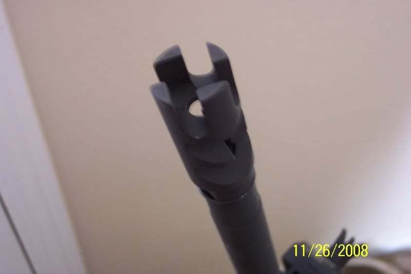

Photos of my M&P15T after the PWS upgrade:
