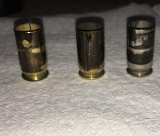

The older Mk23 I owned would consistently shoot premium ammo into a 2.5” group at 50 yards from the bench. The USP Experts will too. This new Mk23’s best group without the suppressor was around 6” at 50 yards benched. Absolutely nowhere near what I’ve had other HK’s do. I also had a handful of brand new Federal Gold Metal Match cases split starting about 1/3 the way up from the casehead all the way to the mouth. The side where the split is was also visually bulged. I am not home yet to check them with the calipers but it looks like all the brass has a slight bulge on one side and is discolored from powder burn. The bulge also starts around 1/3 of the way up from the casehead and forward. It is not like what you would see in a Glock 40 cal where the casehead/base is not supported. Looking inside the chamber I can see heat discoloration on the chamber wall opposite of the ejection port.

Well this does suck. I got home and have around a 0.020 high spot in near every case. I have a machined flat surface at home and I can roll live rounds across it and they roll perfectly smooth. Looking straight under the case where it rolls there is no variation where the surfaces meet. If I roll any of the fired cases there is a definite high spot and you can see the warpedness of the case by the light shining through as it rolls along. It also does the speed up/slow down as it comes and goes over the high spot. I would say the chamber is slightly oval shaped by looking at this brass.

I got some cerrosafe in from Brownells today and just poured a cast of the chamber. Sure enough I have a variance of about 0.020” in the chamber right where the case split. I can rotate the mold 90 degs and get 20 thou difference in my measurement. I’m going to mail it off tomorrow and include the slug so they can use it to help them diagnose the issue.

This picture shows the high spot on a few factory new federal cases. I rolled them in ink with the case rim hanging off the ink pad.
This is 180 degs from the high spot
Blown out brand new federal 230 gr gold metal match
Side view.
You can see discoloration on one wall of the chamber, and these pictures jive with the measurements I took off my chamber cast.
I took these measurements at exactly the same distance down from the case mouth. This variation holds down to roughly the spot where I had the cases split.
Then rotated 90 degs
If I measure the hump I have in the brass it is roughly 0.015-0.020”
