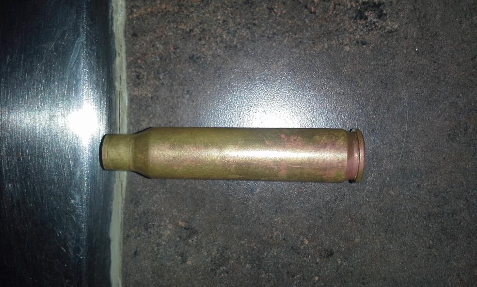

I read on here about brass turning pink when the zinc starts separating. So i went on the hunt for the most weathered,black piece of range brass i could find. I found this one berween the 200 and 300 yard backstop on some rocks,it couldn’t have been blacker if it was painted,but it looked ok not really dirty or dented. I ran it through the vib. tumbler with the range brass i picked up just to see how it would come out.
It was still black but looked ok till i soaked it in some ketchup to get it back to shiny to inspect. I was not going to reload it,just wanted to see how it would come out since it was so weathered. As you can see its pleanty pink.
I posted this for all the new reloaders like myself that have never seen it turn pink. Ive seen it with a reddish tint but never like this, i am thinking this is what you guys mean by pink brass and not to reload it. It has an even pinker spot on the other side.
The picture doesnt show just how bad it really is. Its pink not red.
Leave it out for a few days. If it turns black it’s oxidation. I never heard of zinc separating from brass from shooting it.
After rereading, the pink oxide was under the black and you just exposed it by tumbling. It will polish right off, or you can tumble it longer.
You can have pink brass but it has more zinc in it than cartridge brass.
What you have is fine to reload.
I’ve reloaded plenty of brass which looked like that after cleaning. No issues and it will come right off with a scotch pad if you want it shiny.
Its not oxidized. Its not red. It doesnt come off… From what i understand brass is copper and zinc,its the copper leaching out due to being wet. Ive been told it makes the brass not suitable for pressure.

It is typically caused by too much lemi-shine in a wet tumbler without agitation (not tumbling). Your is probably caused by sitting in the elements for so long. They shoot just fine, and I don’t know the why behind it (physics) but the brass has actually leached out some of the zinc.

How does zinc “Leach” out of brass and where did you guys hear this? Even if the zinc started to “leach” out, it would turn from yellow cartridge brass to more golden like admiral brass, not red.
Cu2O - which is the color shown above and below will oxidizes to CuO in normal/outside environments. Since the copper below is covered, it doesn’t oxidize as much.
As evidence, I did the following (The last pic still shows some “black” which is pitting):
EDIT: to add sorry for the blurry pics - I was shaking.
Brass with black oxidation - after cleaning with tsp it was still black but the carbon was gone.
After soaking in ~10% HCl we got this:
Then I polished the case mouth half of the brass:

If you google ‘galvanic corrosion’, it is the electrons traveling between two dissimilar metals. It is like a minuscule battery charge. The zinc is going to disappear, just like the zinc sacrificial anodes in water heaters, and under boat hulls. The zinc goes before the copper, or SS, etc. I am not going to guess at it being safe or not, just that material is being lost. Hopefully from the surface only, but I don’t know.
Sent with Tapatalk
The only thing close I found was “selective Leaching” basically states that both are lost and the copper autoplates back on the substrate(which would prevent further corrosion, I would think. This would still be safe to shoot unless - like with any other brass - there is pitting.
To be honest I never heard of that before, but it looks like a surface condition. It always polishes off in my experience. Maybe that’s what’s happening (and would still explain turning black), and would also explain where people get “leaching” from… its not what I thought people thought was happening.

It also sounds like it can only happen in a stagnant environment (like brass sitting in a puddle - doh!), as moving water would wash away the copper. Its making a lot more sense now.
So I think I just talked myself into the “corrosion” camp. It should polish off with enough time, but you cant tell how deep it goes, you probably don’t want to shoot it. Thanks for the education, all.

I’d cut a couple open before I even considered reloading brass in this condition, and when in doubt, scrap it.

Load and shoot it. I’ve shot these kind of pick ups in the past with no issue.
If I were loading a batch of precision stuff, I’d skip a piece like this, but for regular blaster stuff, it’s just fine.
