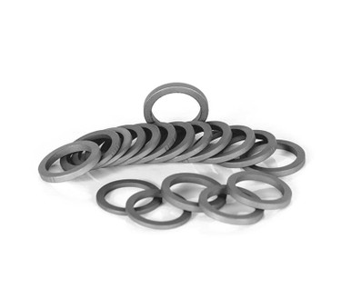

I use Precision Armament Accu-Washers.
Same. I stopped using anything else.

Are the Accu washers beveled on the internal end that goes against the barrel? Or does that not matter?
They have the edges broken on the inside diameter. Call it a very small chamfer.
Dunno if I would call it a ‘bevel’ in the same way that barrel makers use that term to describe their threads.
The washer will cone-out a small amount as you torque against it. To flatten against the shoulder of the barrel. Won’t work with any real taper or other non-spec geometries going on.

I have had trouble with accu-washers on some barrels. The accu-washers will not sit flush against the shoulder unless I bevel the aft edge of the hole by hand.

Another vote for the Accu-Washers. They’re all I use any more. Here’s what Precision Armament says about using them with a suppressor:
Since only one shim is required, the tolerance stackups and complexities associated with peel washers and other multi-shim systems are eliminated. This minimizes the risk of baffle strikes, ensuring maximum accuracy and safety from your muzzle brake or suppressor.
